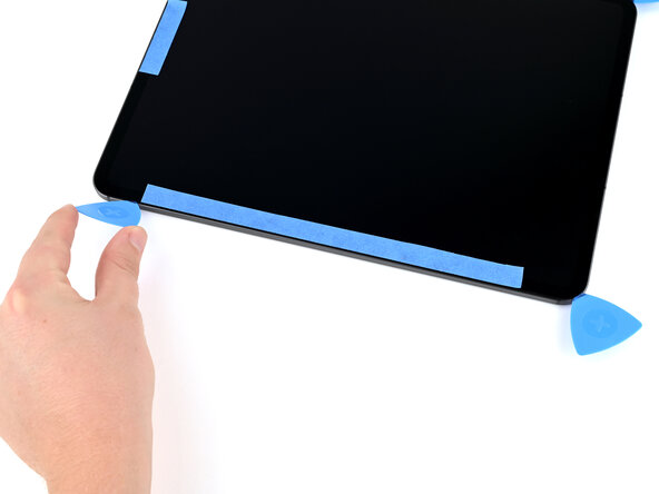

    2. iPad Pro 13" Lock Button Replacement: 步骤 2 中的图像 1,1
      • Note that directions in this guide are given for the iPad in landscape orientation. The USB-C port is on the right edge of the iPad.
      • Place masking tape over the following areas of the display:
      • The TrueDepth camera near the middle of the top edge
      • The ambient light sensor near the middle of the left edge
      • The bottom edge, where there are delicate ribbon cables under the display

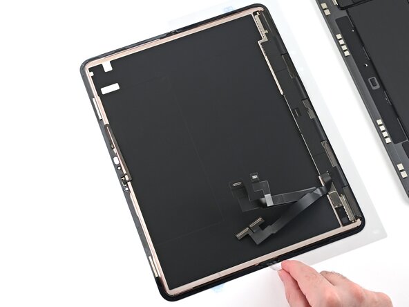

    24. iPad Pro 13" Lock Button Replacement, Remove the screen: 步骤 26 中的图像 1,2 iPad Pro 13" Lock Button Replacement, Remove the screen: 步骤 26 中的图像 2,2
      • Remove the screen.

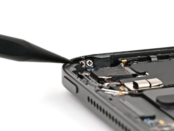

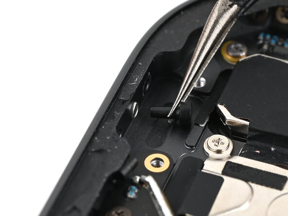

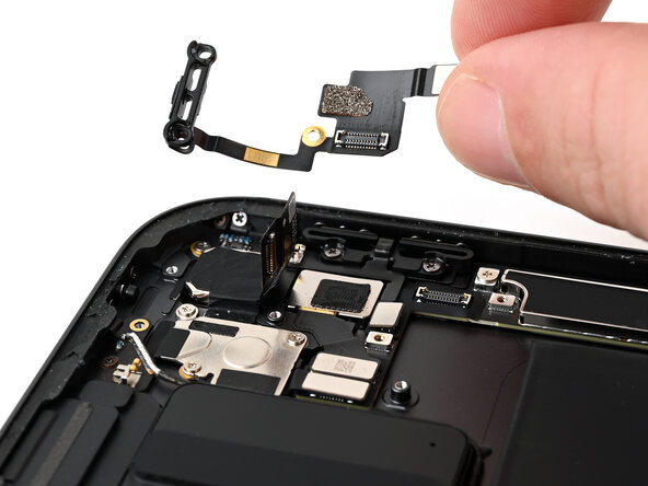

    1. iPad Pro 13" Lock Button Replacement, Remove the lock button screws: 步骤 29 中的图像 1,2 iPad Pro 13" Lock Button Replacement, Remove the lock button screws: 步骤 29 中的图像 2,2
      • Use a JCIS or JIS 00 screwdriver to remove the two screws securing the lock button and bracket:
      • One 2.0 mm‑long screw securing the top of the bracket.
      • One 2.5 mm‑long screw securing the bottom of the bracket.
      • On models without cellular, remove the screws in this image instead.
      询问修复机器人
      添加评论

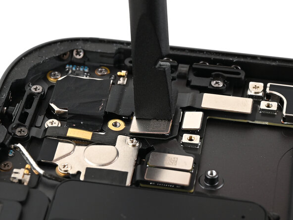

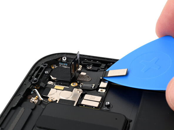

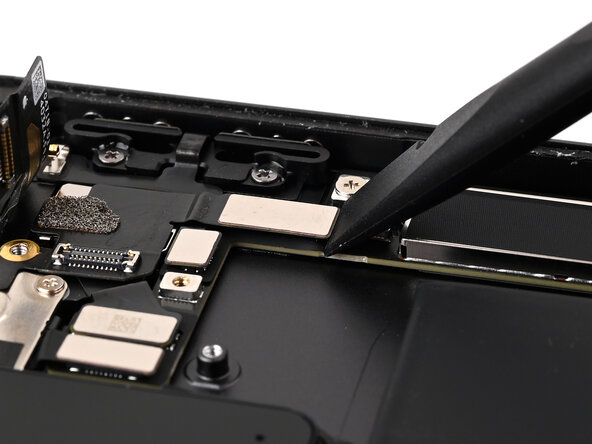

    2. iPad Pro 13" Lock Button Replacement, Disconnect the camera: 步骤 30 中的图像 1,3 iPad Pro 13" Lock Button Replacement, Disconnect the camera: 步骤 30 中的图像 2,3 iPad Pro 13" Lock Button Replacement, Disconnect the camera: 步骤 30 中的图像 3,3
      • Place the flat end of a spudger between the camera ribbon cable and the top button ribbon cable, against the camera press connector.
      • While holding the top button ribbon cable down with the spudger, twist the spudger to disconnect the rear camera press connector.
      • Lift the camera ribbon cable up so it's nearly vertical to keep it out of the way.

    3. iPad Pro 13" Lock Button Replacement, Disconnect the lock button: 步骤 31 中的图像 1,2 iPad Pro 13" Lock Button Replacement, Disconnect the lock button: 步骤 31 中的图像 2,2
      • Use the flat end of a spudger to disconnect the lock button press connector.

    4. iPad Pro 13" Lock Button Replacement, Remove the lock button and bracket: 步骤 32 中的图像 1,3 iPad Pro 13" Lock Button Replacement, Remove the lock button and bracket: 步骤 32 中的图像 2,3 iPad Pro 13" Lock Button Replacement, Remove the lock button and bracket: 步骤 32 中的图像 3,3
      • Slide an opening pick under the lock button press connector.
      • While pressing the opening pick up against the lock button ribbon cable, slide the pick under the cable to release the adhesive securing it to the iPad.
      • There are two pads under the ribbon cable. Be careful not to peel these up. If you do peel them up, place them back in their original positions.
      • Remove the lock button and bracket.
      • If you're just replacing this part and not the lock button cap, skip the next 8 steps.

    6. iPad Pro 13" Lock Button Replacement, Remove the plunger: 步骤 34 中的图像 1,2 iPad Pro 13" Lock Button Replacement, Remove the plunger: 步骤 34 中的图像 2,2
      • Use tweezers or your fingers to remove the plunger from the lock button cap.
      • Note that this is small, non-magnetic, and round, so place it somewhere safe if you're not replacing it!

    8. iPad Pro 13" Lock Button Replacement, Connect the lock button: 步骤 44 中的图像 1,2 iPad Pro 13" Lock Button Replacement, Connect the lock button: 步骤 44 中的图像 2,2
      • Use the flat end of a spudger or your finger to connect the lock button press connector.

    6. iPad Pro 13" Lock Button Replacement, Flip the adhesive over: 步骤 53 中的图像 1,2 iPad Pro 13" Lock Button Replacement, Flip the adhesive over: 步骤 53 中的图像 2,2
      • Flip the adhesive over so it's aligned with the back of the screen.
