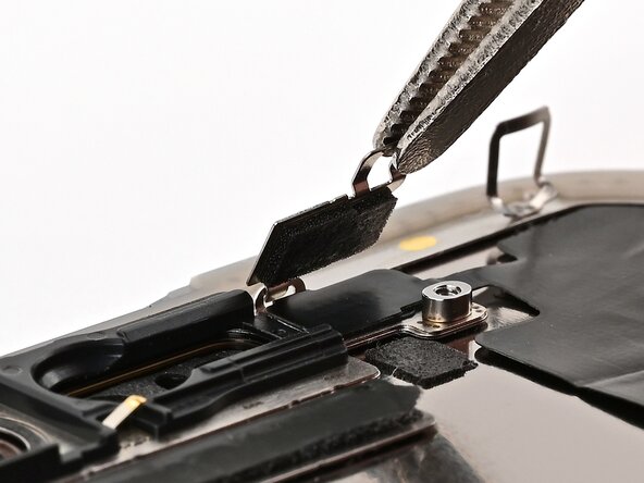

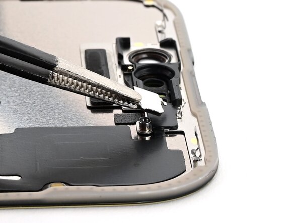

  19. iPhone 16 Pro Max Screen Replacement, Remove the ambient light sensor bracket: 步骤 19 中的图像 1,2 iPhone 16 Pro Max Screen Replacement, Remove the ambient light sensor bracket: 步骤 19 中的图像 2,2
    • Use a Phillips screwdriver to remove the 1 mm‑long screw securing the bracket on the ambient light sensor.
  20. iPhone 16 Pro Max Screen Replacement: 步骤 20 中的图像 1,2 iPhone 16 Pro Max Screen Replacement: 步骤 20 中的图像 2,2
    • Use a pair of tweezers or your fingers to lift and remove the ambient light sensor bracket.

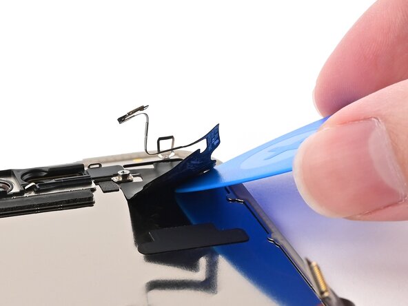

  21. iPhone 16 Pro Max Screen Replacement, Heat the ambient light sensor cable: 步骤 21 中的图像 1,1
    • Use a hair dryer, heat gun, or iOpener to soften the adhesive under the ambient light sensor and ambient light sensor cable.

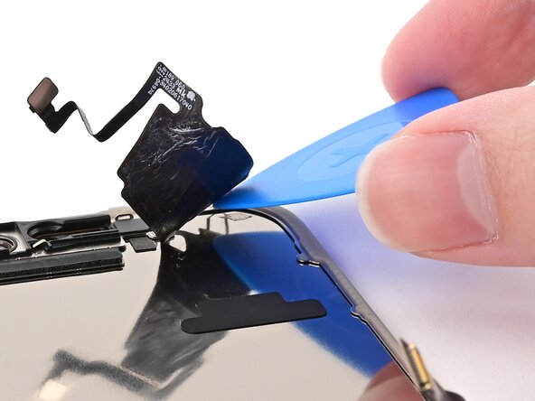

  22. iPhone 16 Pro Max Screen Replacement, Peel up the ambient light sensor cable: 步骤 22 中的图像 1,3 iPhone 16 Pro Max Screen Replacement, Peel up the ambient light sensor cable: 步骤 22 中的图像 2,3 iPhone 16 Pro Max Screen Replacement, Peel up the ambient light sensor cable: 步骤 22 中的图像 3,3
    • Be careful and work slowly—the cable is extremely delicate, especially near the sensor. Don't try to lift the sensor itself yet.
    • Slowly slide an opening pick under the ambient light sensor cable, starting under the connector at the bottom and working upwards until the cable is free from the screen.
    • If the adhesive doesn't peel up easily, apply more heat.

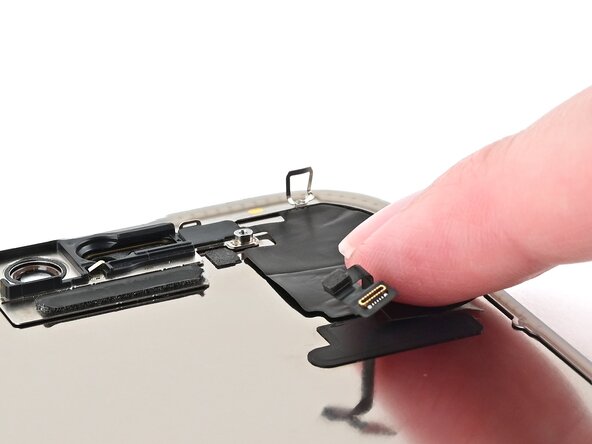

  27. iPhone 16 Pro Max Screen Replacement, Warm the ambient light sensor cable: 步骤 27 中的图像 1,1
    • Use a hair dryer, heat gun, or iOpener to soften the adhesive under the ambient light sensor and its cable. It only needs to be warm—not hot.
  28. iPhone 16 Pro Max Screen Replacement, Press the ambient light sensor: 步骤 28 中的图像 1,3 iPhone 16 Pro Max Screen Replacement, Press the ambient light sensor: 步骤 28 中的图像 2,3 iPhone 16 Pro Max Screen Replacement, Press the ambient light sensor: 步骤 28 中的图像 3,3
    在这个步骤中使用的工具:
    Tesa 61395 Tape
    $2.99
    • Use your finger to press down the ambient light sensor cable.
    • If the ambient light sensor cable isn't sticking, apply a few small pieces of thin, double‑sided tape, like Tesa tape, to the back of the sensor cable.

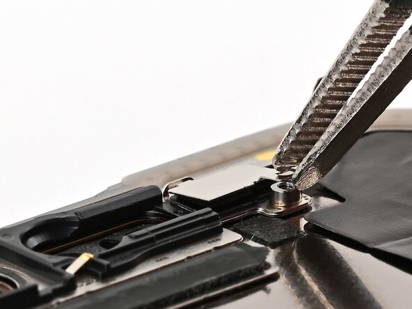

  29. iPhone 16 Pro Max Screen Replacement, Install the ambient light sensor bracket: 步骤 29 中的图像 1,3 iPhone 16 Pro Max Screen Replacement, Install the ambient light sensor bracket: 步骤 29 中的图像 2,3 iPhone 16 Pro Max Screen Replacement, Install the ambient light sensor bracket: 步骤 29 中的图像 3,3
    • Use tweezers or your fingers to hook the ambient light sensor bracket over the back of the sensor and set it into place.
  30. iPhone 16 Pro Max Screen Replacement: 步骤 30 中的图像 1,1
    • Use a Phillips screwdriver to install the 1 mm‑long screw securing the bracket on the ambient light sensor.

    • Use your finger to press down and connect the display connector.
    • To re-attach wide press connectors like this one, carefully align and press down on one side until it clicks into place, then repeat on the other side. Don't press down in the middle. If the connector is misaligned, the pins can bend, causing permanent damage.
    • Press down and connect the front sensor connector.
    • Align the connector carefully over its socket and press down with your fingertip until it clicks into place. Don't try to force the connector into place. If you're having trouble, reposition it and try again.
    • This is a good time to power on your iPhone and test all functions before you seal it up. Be sure to power your iPhone back down completely before you continue.
    • If your iPhone doesn't turn on, connect it to a power source and try again.
