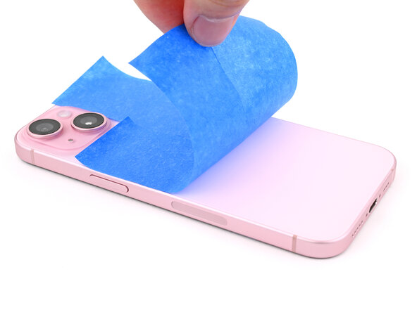

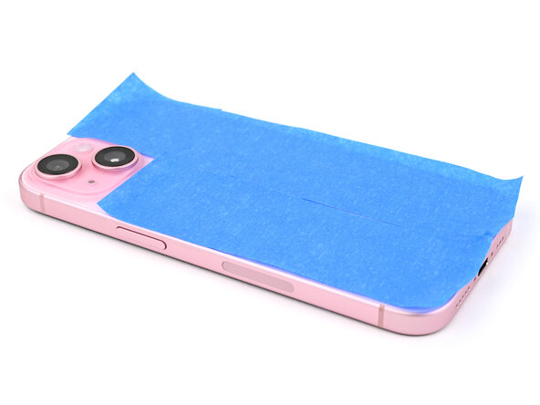

  2. iPhone 15 Screen Replacement, Tape over any cracks: 步骤 2 中的图像 1,2 iPhone 15 Screen Replacement, Tape over any cracks: 步骤 2 中的图像 2,2
    • If your screen or back glass is badly cracked, lay overlapping strips of packing tape over the glass to protect yourself and make disassembly easier.
    • Make sure there's a smooth area near the bottom edge that's big enough for a suction cup to stick to.

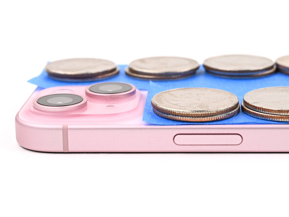

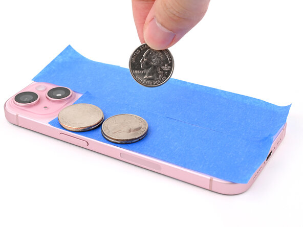

  3. iPhone 15 Screen Replacement, Mark your opening picks: 步骤 3 中的图像 1,3 iPhone 15 Screen Replacement, Mark your opening picks: 步骤 3 中的图像 2,3 iPhone 15 Screen Replacement, Mark your opening picks: 步骤 3 中的图像 3,3
    • If inserted too far, an opening pick can damage your device. Follow this step to mark your pick and prevent damage.
    • Measure 3 mm from the tip and mark the opening pick with a permanent marker.
    • You can also mark the other corners of the pick with different measurements.
    • Alternatively, tape a coin to a pick 3 mm from the tip.

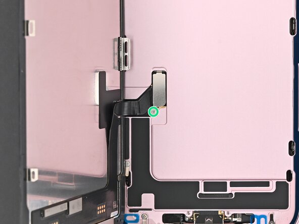

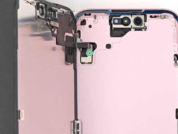

  19. iPhone 15 Screen Replacement, Unfasten the front sensor connector cover: 步骤 19 中的图像 1,1
    • Use a tri-point Y000 driver to remove the 0.9 mm-long screw securing the front sensor connector cover.
    询问修复机器人
    添加评论

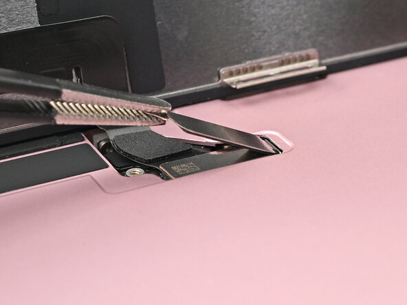

  20. iPhone 15 Screen Replacement, Remove the cover: 步骤 20 中的图像 1,3 iPhone 15 Screen Replacement, Remove the cover: 步骤 20 中的图像 2,3 iPhone 15 Screen Replacement, Remove the cover: 步骤 20 中的图像 3,3
    在这个步骤中使用的工具:
    • Use tweezers to lift the cover to a 90-degree angle.
    • Unhook the cover from its slot in the logic board.
    • Remove the cover.

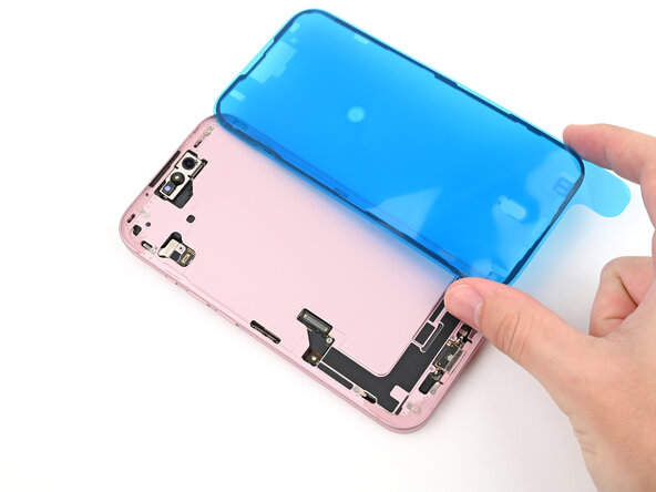

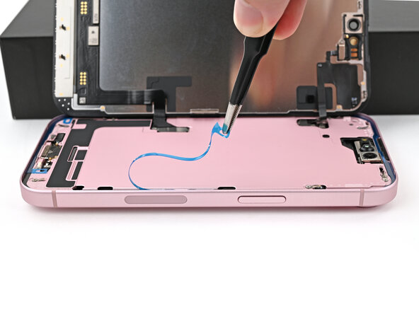

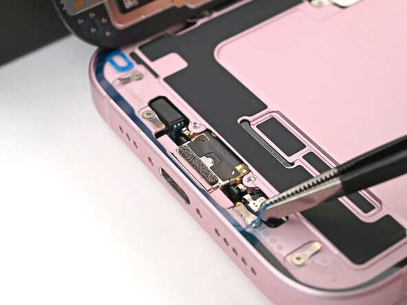

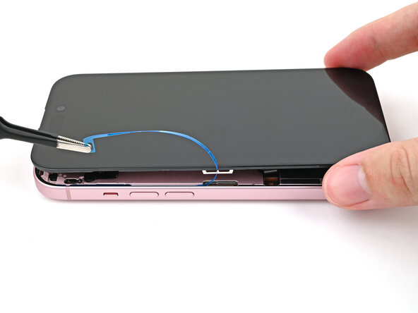

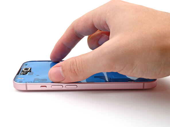

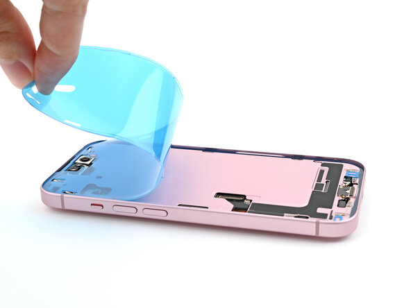

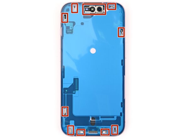

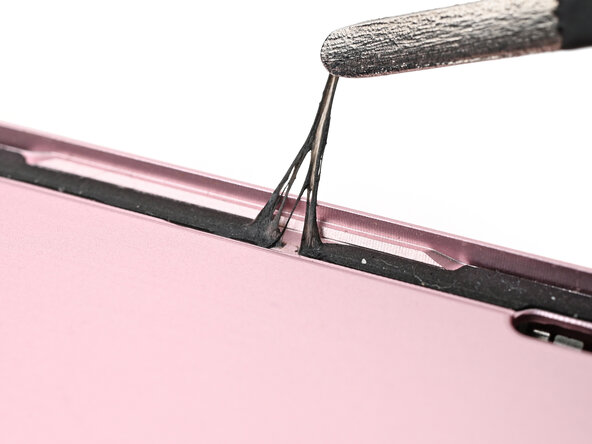

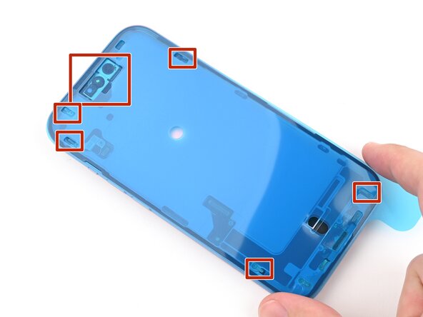

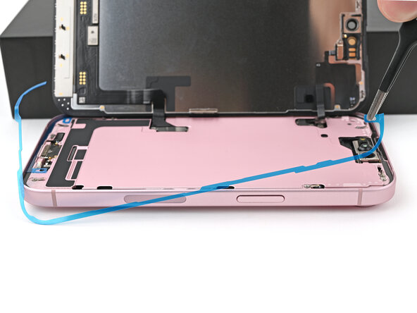

  27. iPhone 15 Screen Replacement, Remove the screen adhesive: 步骤 27 中的图像 1,3 iPhone 15 Screen Replacement, Remove the screen adhesive: 步骤 27 中的图像 2,3 iPhone 15 Screen Replacement, Remove the screen adhesive: 步骤 27 中的图像 3,3
    • Be careful not to damage any of the spring contacts as you clean the frame.
    • This is a good point to test your repair before sealing up your phone. Connect the screen, power on your phone, and make sure it works as expected. Power it back down and continue reassembly.
    • The adhesive remaining on your phone is difficult to remove and leaves residue. If you have trouble removing the adhesive, apply some heat using a hair dryer or heat gun.
    • Use a spudger to push the screen adhesive up until you can grab it with a pair of tweezers.
    • Use a pair of tweezers, or your fingers, to remove the adhesive around the entire perimeter of the iPhone.

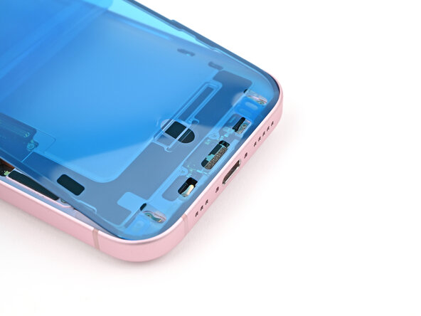

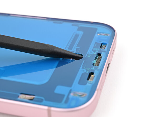

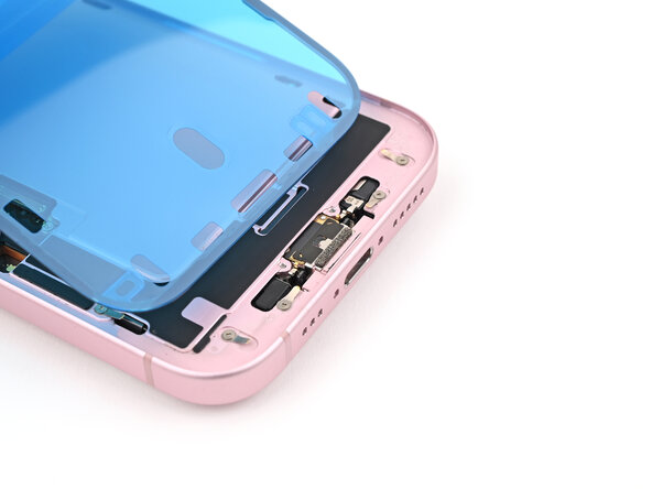

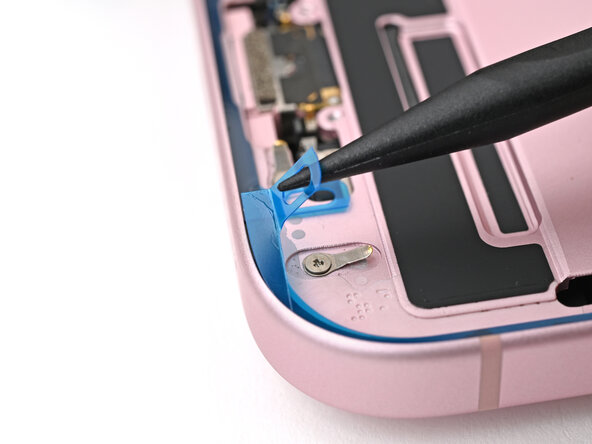

  28. iPhone 15 Screen Replacement: 步骤 28 中的图像 1,3 iPhone 15 Screen Replacement: 步骤 28 中的图像 2,3 iPhone 15 Screen Replacement: 步骤 28 中的图像 3,3
    • Any leftover residue will compromise your iPhone's seal. Be sure to clean the frame thoroughly.
    • Wrap a microfiber or lint-free cloth around the pointed end of a spudger and apply a few drops of high-concentration (greater than 90%) isopropyl alcohol to the cloth.
    • Wipe in one direction along the perimeter of the frame to clean the adhesive residue.
    • Wait a few minutes before proceeding to make sure any excess alcohol has evaporated.

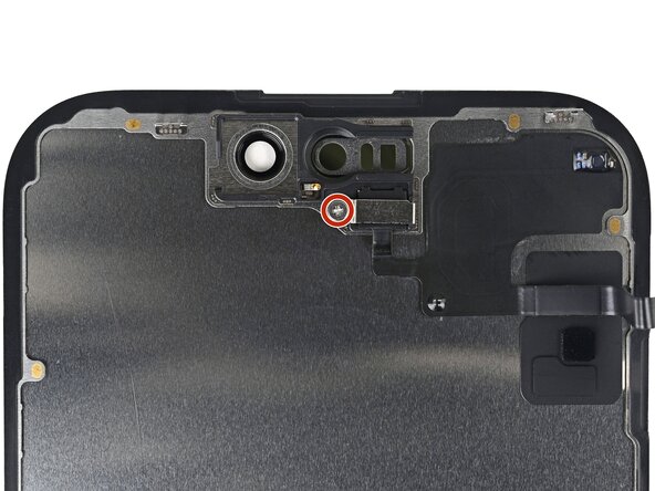

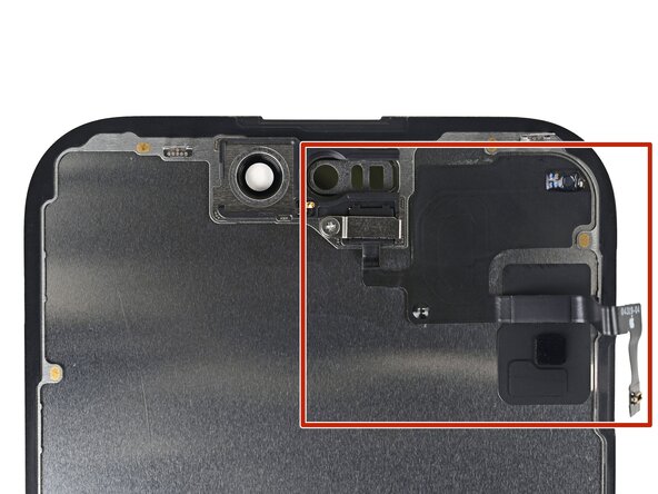

  29. iPhone 15 Screen Replacement, Ambient light sensor information: 步骤 29 中的图像 1,1
    • The ambient light sensor is located behind the screen, directly beneath the cut‑out for the Face ID sensors.
    • Check if the replacement screen comes with one installed. If it does, skip to this step.

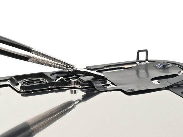

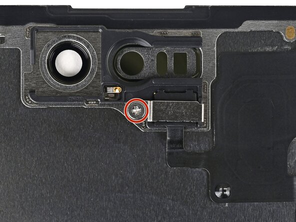

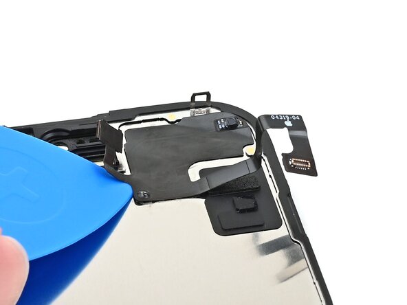

  30. iPhone 15 Screen Replacement, Remove the ambient light sensor bracket: 步骤 30 中的图像 1,2 iPhone 15 Screen Replacement, Remove the ambient light sensor bracket: 步骤 30 中的图像 2,2
    • Use a Phillips screwdriver to remove the 1.3 mm‑long screw securing the ambient light sensor bracket.
    询问修复机器人
    添加评论
  31. iPhone 15 Screen Replacement: 步骤 31 中的图像 1,2 iPhone 15 Screen Replacement: 步骤 31 中的图像 2,2
    • Use a pair of tweezers or your fingers to lift and remove the ambient light sensor bracket.
    询问修复机器人

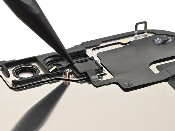

  33. iPhone 15 Screen Replacement, Pry up the ambient light sensor: 步骤 33 中的图像 1,2 iPhone 15 Screen Replacement, Pry up the ambient light sensor: 步骤 33 中的图像 2,2
    • Use a spudger to pry up the ambient light sensor.
    询问修复机器人
    添加评论

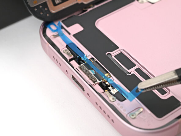

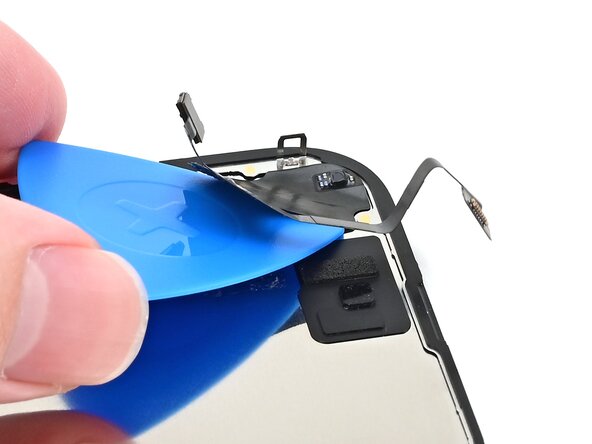

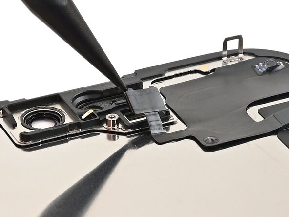

  34. iPhone 15 Screen Replacement, Peel up the ambient light sensor cable: 步骤 34 中的图像 1,2 iPhone 15 Screen Replacement, Peel up the ambient light sensor cable: 步骤 34 中的图像 2,2
    • Gently slide an opening pick under the ambient light sensor cable, starting near the sensor and moving towards to the opposite corner until it's free from the screen.
    • If the adhesive doesn't peel up easily, apply more heat.
    询问修复机器人
    添加评论

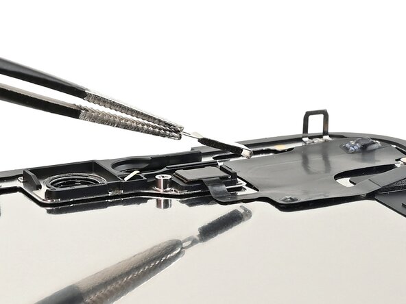

  35. iPhone 15 Screen Replacement, Remove the ambient light sensor: 步骤 35 中的图像 1,1
    • Use a pair of tweezers to lift the ambient light sensor off of the screen.

    • Use a Phillips screwdriver to install the 1.3 mm‑long screw securing the ambient light sensor bracket.

  42. iPhone 15 Screen Replacement, Orient the adhesive: 步骤 42 中的图像 1,3 iPhone 15 Screen Replacement, Orient the adhesive: 步骤 42 中的图像 2,3 iPhone 15 Screen Replacement, Orient the adhesive: 步骤 42 中的图像 3,3
    • Lay the adhesive next to the phone and use features like cutouts for spring contacts and the front‑facing camera to make sure the adhesive is oriented correctly.
    • Your adhesive may look slightly different.
    询问修复机器人
    添加评论
  43. iPhone 15 Screen Replacement, Apply the adhesive: 步骤 43 中的图像 1,3 iPhone 15 Screen Replacement, Apply the adhesive: 步骤 43 中的图像 2,3 iPhone 15 Screen Replacement, Apply the adhesive: 步骤 43 中的图像 3,3
    • Once the adhesive is pressed into place, you can't reposition it—you'll have to remove it and start over with new adhesive.
    • Use the pull tab to begin peeling the back liner off of the adhesive starting from the bottom, but do not remove the liner all the way.
    • While holding the back liner out of the way, carefully align the exposed edge of the adhesive to the bottom edge of the iPhone's frame.
    询问修复机器人
    添加评论
  44. iPhone 15 Screen Replacement: 步骤 44 中的图像 1,3 iPhone 15 Screen Replacement: 步骤 44 中的图像 2,3 iPhone 15 Screen Replacement: 步骤 44 中的图像 3,3
    • When the adhesive is aligned, use the flat end of a spudger, or your finger, to press it down firmly along the bottom edge.

  46. iPhone 15 Screen Replacement, Press the adhesive into place: 步骤 46 中的图像 1,3 iPhone 15 Screen Replacement, Press the adhesive into place: 步骤 46 中的图像 2,3 iPhone 15 Screen Replacement, Press the adhesive into place: 步骤 46 中的图像 3,3
    • Make sure the liner is aligned properly by checking that all spring contacts and the front-facing camera are in their cutouts. If they aren't, remove the adhesive and start over with a new sheet.
    • Use the flat end of a spudger to press the adhesive firmly into place all around the iPhone.
    • Be careful not to press on the camera, spring contacts, or other internal components.

  47. iPhone 15 Screen Replacement, Remove the top liner: 步骤 47 中的图像 1,2 iPhone 15 Screen Replacement, Remove the top liner: 步骤 47 中的图像 2,2
    • Insert the point of a spudger under the top liner's hole at the bottom of the frame.
    • Pry up to separate the liner from the frame—enough to grip it with your fingers.
    • Your pull tab may be in a different location. Make sure you're pulling the full-size top liner, not the thin liners under it.

  48. iPhone 15 Screen Replacement: 步骤 48 中的图像 1,3 iPhone 15 Screen Replacement: 步骤 48 中的图像 2,3 iPhone 15 Screen Replacement: 步骤 48 中的图像 3,3
    • Peel back the top liner and remove it.
    询问修复机器人

  50. iPhone 15 Screen Replacement, Connect the screen: 步骤 50 中的图像 1,2 iPhone 15 Screen Replacement, Connect the screen: 步骤 50 中的图像 2,2
    • Use the flat end of a spudger or your finger to connect the screen and front sensor press connectors.
    询问修复机器人
    添加评论
  51. iPhone 15 Screen Replacement: 步骤 51 中的图像 1,3 iPhone 15 Screen Replacement: 步骤 51 中的图像 2,3 iPhone 15 Screen Replacement: 步骤 51 中的图像 3,3
    • Insert the top of the screen connector cover into its slot in the frame and lay it over the press connector.
    询问修复机器人
    添加评论

  54. iPhone 15 Screen Replacement, Remove the final adhesive liners: 步骤 54 中的图像 1,2 iPhone 15 Screen Replacement, Remove the final adhesive liners: 步骤 54 中的图像 2,2
    • As you remove the liners in this step, the adhesive will be fully exposed. Make sure nothing touches the exposed adhesive.
    • Use a spudger, or your fingers, to separate the pull tabs at the bottom right corner of the frame.

  55. iPhone 15 Screen Replacement: 步骤 55 中的图像 1,3 iPhone 15 Screen Replacement: 步骤 55 中的图像 2,3 iPhone 15 Screen Replacement: 步骤 55 中的图像 3,3
    • Remove the narrow liner covering the adhesive along the right and top edges of the frame.
    询问修复机器人
    添加评论
  56. iPhone 15 Screen Replacement: 步骤 56 中的图像 1,3 iPhone 15 Screen Replacement: 步骤 56 中的图像 2,3 iPhone 15 Screen Replacement: 步骤 56 中的图像 3,3
    • Remove the liner along the bottom edge of the frame.
    询问修复机器人
    添加评论
  57. iPhone 15 Screen Replacement: 步骤 57 中的图像 1,3 iPhone 15 Screen Replacement: 步骤 57 中的图像 2,3 iPhone 15 Screen Replacement: 步骤 57 中的图像 3,3
    • Without letting the screen touch the adhesive, hold the screen over the phone so you can access the final liner along the left edge of the phone.
    • Use a pair of tweezers or your fingers to remove the final liner along the left edge of the phone.
    询问修复机器人

  61. iPhone 15 Screen Replacement: 步骤 61 中的图像 1,2 iPhone 15 Screen Replacement: 步骤 61 中的图像 2,2
    • If you don't have the original box for your iPhone, follow the next three steps for another method to evenly compress the screen.
    • Place the iPhone screen-side-down on a soft, flat surface.
    • Apply tape to the back glass to protect its finish.

  62. iPhone 15 Screen Replacement: 步骤 62 中的图像 1,3 iPhone 15 Screen Replacement: 步骤 62 中的图像 2,3 iPhone 15 Screen Replacement: 步骤 62 中的图像 3,3
    • Place evenly spaced layers of coins or similarly thick objects on the tape along the edges of the back glass.
    • Stack them to a consistent height taller than the camera bump.
    询问修复机器人
