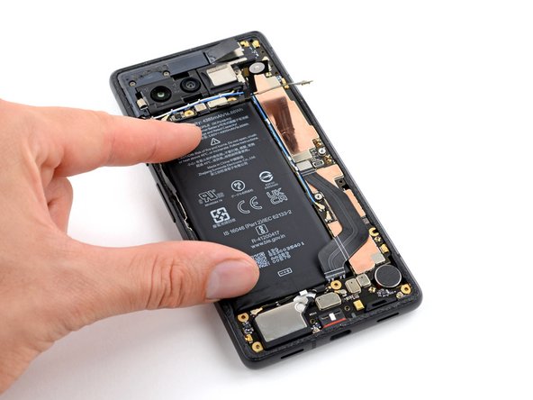

    19. Google Pixel 7a Battery Replacement, Remove the rear cover: 步骤 20 中的图像 1,2 Google Pixel 7a Battery Replacement, Remove the rear cover: 步骤 20 中的图像 2,2
      • Remove the rear cover.
      • During reassembly:
      • Now is a good time to test your phone before sealing it up. Power it on and check that it works. Power it back down before you continue reassembly.
      • Follow this guide to apply new adhesive and install your rear cover.

    9. Google Pixel 7a Battery Replacement, Remove the battery: 步骤 41 中的图像 1,2 Google Pixel 7a Battery Replacement, Remove the battery: 步骤 41 中的图像 2,2
      • Remove the battery.
