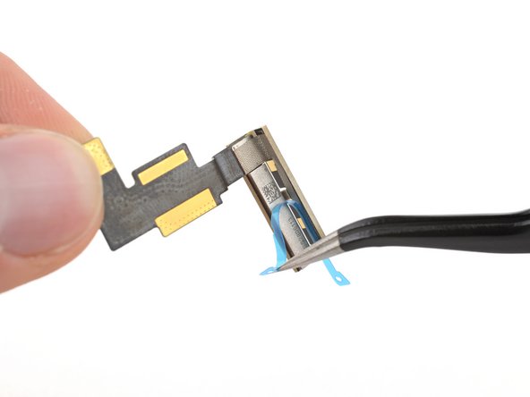

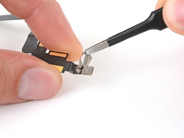

  30. Google Pixel 7a 5G mmWave Antenna Replacement, Remove the connector cover: 步骤 30 中的图像 1,3 Google Pixel 7a 5G mmWave Antenna Replacement, Remove the connector cover: 步骤 30 中的图像 2,3 Google Pixel 7a 5G mmWave Antenna Replacement, Remove the connector cover: 步骤 30 中的图像 3,3
    在这个步骤中使用的工具:
    • Use your 1IP Torx Plus driver to remove the 1.5 mm screw securing the connector cover.
    • Use tweezers or your fingers to remove the cover.
    • During reassembly, place the upper left corner of the cover under the hook on the logic board before installing its screw.
    添加评论

  53. Google Pixel 7a 5G mmWave Antenna Replacement, Remove the 5G mmWave antenna cable: 步骤 53 中的图像 1,2 Google Pixel 7a 5G mmWave Antenna Replacement, Remove the 5G mmWave antenna cable: 步骤 53 中的图像 2,2
    • Conductive tape secures the 5G mmWave antenna to its cable. In this step, you'll disconnect the cable before peeling off the tape.
    • Grab the cable as close to the head of the connector as possible.
    • Pry the connector away from the antenna to disconnect it.
    询问修复机器人

  54. Google Pixel 7a 5G mmWave Antenna Replacement: 步骤 54 中的图像 1,3 Google Pixel 7a 5G mmWave Antenna Replacement: 步骤 54 中的图像 2,3 Google Pixel 7a 5G mmWave Antenna Replacement: 步骤 54 中的图像 3,3
    在这个步骤中使用的工具:
    • Lift the 5G mmWave antenna cable upward and peel it from the antenna.
    • If the conductive tape rips, peel the remaining pieces off with tweezers or your fingers.
    询问修复机器人

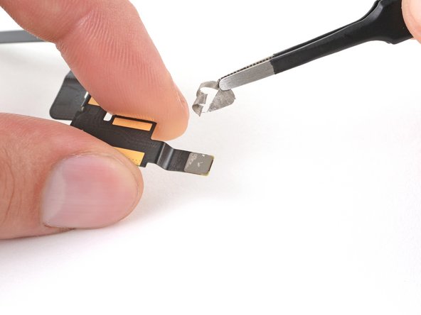

  56. Google Pixel 7a 5G mmWave Antenna Replacement, Prepare the cable for reassembly: 步骤 56 中的图像 1,3 Google Pixel 7a 5G mmWave Antenna Replacement, Prepare the cable for reassembly: 步骤 56 中的图像 2,3 Google Pixel 7a 5G mmWave Antenna Replacement, Prepare the cable for reassembly: 步骤 56 中的图像 3,3
    • Peel and remove the conductive tape from the head of the cable.
    询问修复机器人

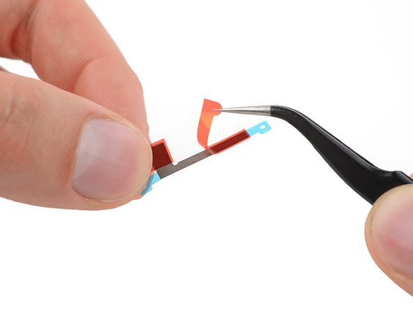

  57. Google Pixel 7a 5G mmWave Antenna Replacement, Prepare your 5G mmWave antenna for reassembly: 步骤 57 中的图像 1,3 Google Pixel 7a 5G mmWave Antenna Replacement, Prepare your 5G mmWave antenna for reassembly: 步骤 57 中的图像 2,3 Google Pixel 7a 5G mmWave Antenna Replacement, Prepare your 5G mmWave antenna for reassembly: 步骤 57 中的图像 3,3
    • The next three steps show how to reconnect the 5G mmWave antenna cable and apply new adhesive. If you don't have replacement adhesive, skip the remaining steps.
    • Peel your replacement adhesive off of the large liner.
    • Remove the two red liners to expose the sticky side of the adhesive.
    询问修复机器人

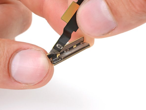

  58. Google Pixel 7a 5G mmWave Antenna Replacement: 步骤 58 中的图像 1,3 Google Pixel 7a 5G mmWave Antenna Replacement: 步骤 58 中的图像 2,3 Google Pixel 7a 5G mmWave Antenna Replacement: 步骤 58 中的图像 3,3
    • Reconnect the 5G mmWave antenna cable.
    • Apply the square tab of the adhesive strip onto the head of the connector and the long edge onto the thin, upright side of the antenna.
    询问修复机器人
