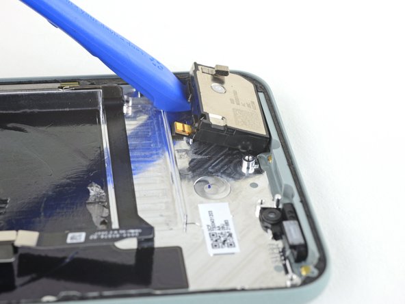

  42. Google Pixel 5 Loudspeaker Replacement, Pry out the loudspeaker: 步骤 42 中的图像 1,2 Google Pixel 5 Loudspeaker Replacement, Pry out the loudspeaker: 步骤 42 中的图像 2,2
    • Insert the spudger into the crevice between the loudspeaker and the rear case.
    • Pry the loudspeaker away from the edge of the case.
    • This may be difficult depending upon the age and strength of the adhesive.
  43. Google Pixel 5 Loudspeaker Replacement: 步骤 43 中的图像 1,2 Google Pixel 5 Loudspeaker Replacement: 步骤 43 中的图像 2,2
    • Insert the opening tool between the loudspeaker and the rear case.
    • Pry the loudspeaker off the rear case.

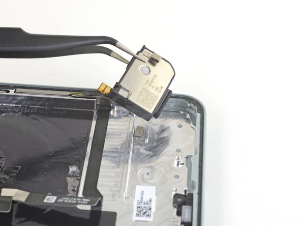

  44. Google Pixel 5 Loudspeaker Replacement: 步骤 44 中的图像 1,2 Google Pixel 5 Loudspeaker Replacement: 步骤 44 中的图像 2,2
    在这个步骤中使用的工具:
    • Use tweezers to remove the loudspeaker from the rear case.
