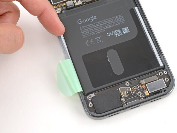

  22. Google Pixel 10 Pro XL Battery Replacement, Peel up the battery pull tab: 步骤 22 中的图像 1,3 Google Pixel 10 Pro XL Battery Replacement, Peel up the battery pull tab: 步骤 22 中的图像 2,3 Google Pixel 10 Pro XL Battery Replacement, Peel up the battery pull tab: 步骤 22 中的图像 3,3
    • Use your fingers to peel up the entire battery tab on the left side of the battery, including the skinny strip running along the side.

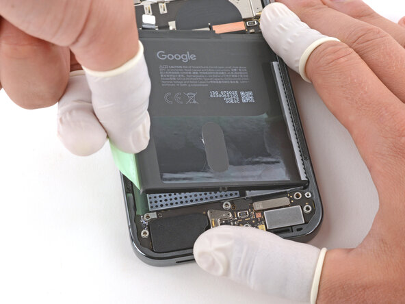

  24. Google Pixel 10 Pro XL Battery Replacement, Separate the battery adhesive: 步骤 24 中的图像 1,3 Google Pixel 10 Pro XL Battery Replacement, Separate the battery adhesive: 步骤 24 中的图像 2,3 Google Pixel 10 Pro XL Battery Replacement, Separate the battery adhesive: 步骤 24 中的图像 3,3
    • Secure the right side of your phone with one hand, and use your free hand to grip the battery pull tab.
    • Make sure your hand securing the phone is mainly pressing on the frame—it shouldn't be covering the battery or pressing down on delicate components.
    • Pull straight up on the tab and apply constant, steady force until the adhesive separates.

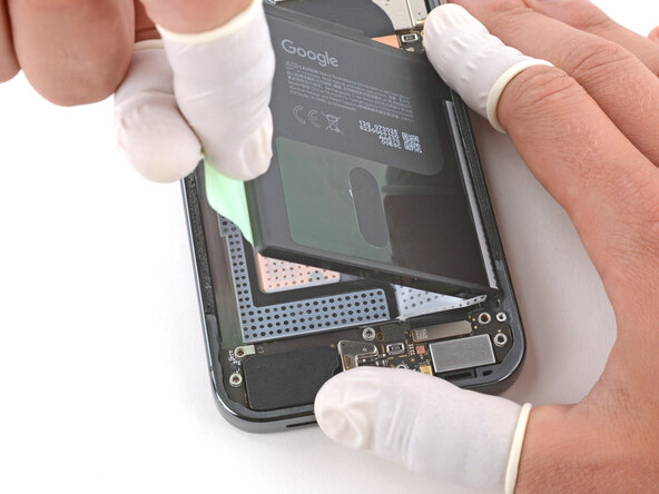

  25. Google Pixel 10 Pro XL Battery Replacement, Remove the battery: 步骤 25 中的图像 1,3 Google Pixel 10 Pro XL Battery Replacement, Remove the battery: 步骤 25 中的图像 2,3 Google Pixel 10 Pro XL Battery Replacement, Remove the battery: 步骤 25 中的图像 3,3
    • Grip the battery and slowly pull it away from your phone to peel the plastic sleeve out of the recess.
    • Remove the battery.

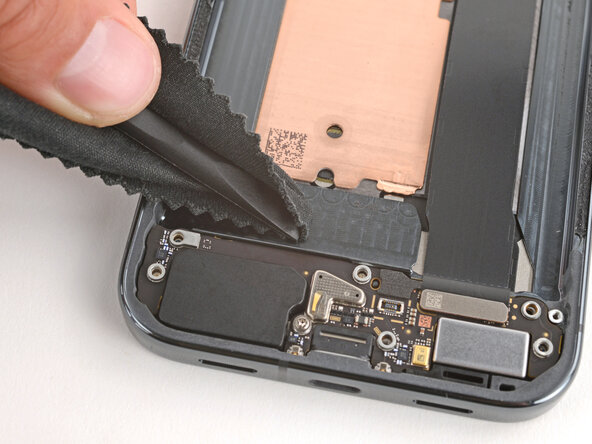

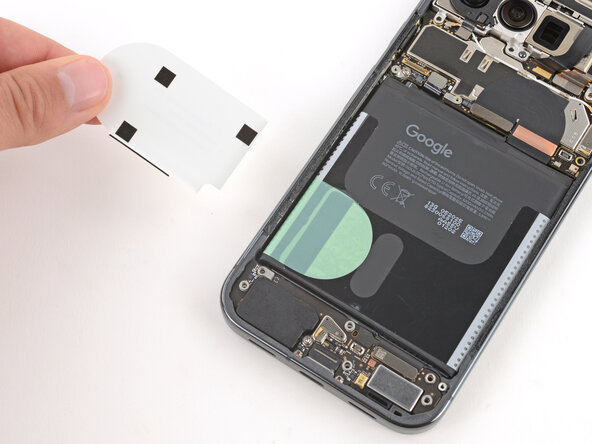

  27. Google Pixel 10 Pro XL Battery Replacement, Clean the battery recess: 步骤 27 中的图像 1,3 Google Pixel 10 Pro XL Battery Replacement, Clean the battery recess: 步骤 27 中的图像 2,3 Google Pixel 10 Pro XL Battery Replacement, Clean the battery recess: 步骤 27 中的图像 3,3
    • Before installing a new battery, check the recess for leftover bits of plastic, as well as adhesive residue from the battery sleeve.
    • If the battery came out cleanly, you can skip this step.
    • Remove any bits of plastic from the old battery sleeve.
    • Use one or two drops high‑concentration (>90%) isopropyl alcohol and a microfiber or lint‑free cloth to clean up any adhesive residue.
    • Be careful not to get alcohol in the cutouts in the battery recess—the bottom of the screen is exposed and may get damaged.
    • Allow the alcohol to dry completely before continuing.

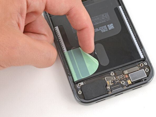

  28. Google Pixel 10 Pro XL Battery Replacement, Remove the battery liner: 步骤 28 中的图像 1,1
    • Remove the large, colored liner from the battery to expose the adhesive.
  29. Google Pixel 10 Pro XL Battery Replacement, Install the battery: 步骤 29 中的图像 1,3 Google Pixel 10 Pro XL Battery Replacement, Install the battery: 步骤 29 中的图像 2,3 Google Pixel 10 Pro XL Battery Replacement, Install the battery: 步骤 29 中的图像 3,3
    • Hold the battery above its recess and use your finger to push down and reconnect the battery press connector.
    • Temporarily reconnecting the battery ensures that it's sitting properly in its recess.
    • Lay the battery into its recess and press down firmly to secure it.

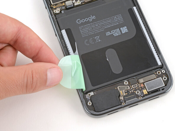

  31. Google Pixel 10 Pro XL Battery Replacement: 步骤 31 中的图像 1,2 Google Pixel 10 Pro XL Battery Replacement: 步骤 31 中的图像 2,2
    • Use your fingers to remove any remaining stickers or liners from the battery.

  47. Google Pixel 10 Pro XL Battery Replacement, Remove the large colored liner: 步骤 47 中的图像 1,3 Google Pixel 10 Pro XL Battery Replacement, Remove the large colored liner: 步骤 47 中的图像 2,3 Google Pixel 10 Pro XL Battery Replacement, Remove the large colored liner: 步骤 47 中的图像 3,3
    • Slowly peel up and remove the large colored liner, gripping it from the cutout near the top edge.
    • If the adhesive starts to peel up with the liner, check that you’ve pushed all of it into place with your spudger. If it continues to peel up, hold it down with the point of your spudger as you go.
