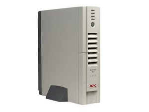

APC RS 1000 是一款输出功率为 600 瓦的不间断电源。
How to open Device open
How to open device ?????
回答此问题 我也有这个问题

How to change the batteries in APC RS 1000 inverter

@smartpack
Click on the "this video" link in the 2nd Answer below

To change out the battery there is a slide out door on the bottom to gain access to the sealed Lead Acid battery inside.

@usmeeabdo there are two lead acid batteries that provide the backup power. There is a resettable fuse in the back, in case your issue is related to now coming on. To actually work on it, use something like this video for a complete teardown. If you have any specific issues with your UPS let us know what those issues are. That way we can be more specific.
