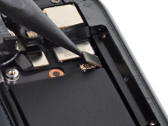

  29. iPad mini 5 Wi-Fi Volume Button Cable Replacement, Disconnect the display press connectors: 步骤 29 中的图像 1,2 iPad mini 5 Wi-Fi Volume Button Cable Replacement, Disconnect the display press connectors: 步骤 29 中的图像 2,2
    • Use the pointed end of a spudger to disconnect the digitizer press connector from the logic board.
  30. iPad mini 5 Wi-Fi Volume Button Cable Replacement: 步骤 30 中的图像 1,3 iPad mini 5 Wi-Fi Volume Button Cable Replacement: 步骤 30 中的图像 2,3 iPad mini 5 Wi-Fi Volume Button Cable Replacement: 步骤 30 中的图像 3,3
    • Use the pointed end of a spudger to disconnect the second and third display press connectors.

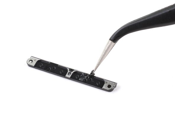

  38. iPad mini 5 Wi-Fi Volume Button Cable Replacement, Remove the volume control bracket: 步骤 38 中的图像 1,1
    • Lift and remove the volume control bracket.

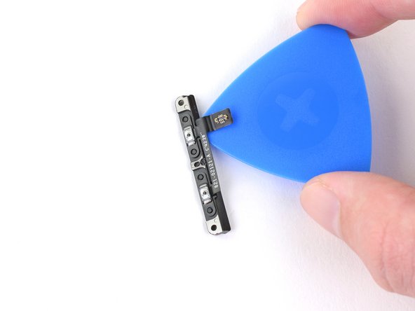

  39. iPad mini 5 Wi-Fi Volume Button Cable Replacement, Remove the volume button cable from the bracket: 步骤 39 中的图像 1,2 iPad mini 5 Wi-Fi Volume Button Cable Replacement, Remove the volume button cable from the bracket: 步骤 39 中的图像 2,2
    • Use an opening pick to cut through the adhesive securing the volume button cable to the bracket.
  40. iPad mini 5 Wi-Fi Volume Button Cable Replacement: 步骤 40 中的图像 1,2 iPad mini 5 Wi-Fi Volume Button Cable Replacement: 步骤 40 中的图像 2,2
    • Continue to use an opening pick to cut through the adhesive securing the volume buttons to the bracket.

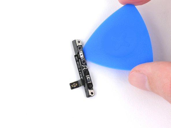

  41. iPad mini 5 Wi-Fi Volume Button Cable Replacement: 步骤 41 中的图像 1,2 iPad mini 5 Wi-Fi Volume Button Cable Replacement: 步骤 41 中的图像 2,2
    • Remove the volume button cable from the bracket.
    • To install a new volume button cable:
    • Remove any remaining adhesive and residue from the bracket.
    • If your part doesn't come with adhesive preinstalled:
    • Follow this guide if you are using a pre-cut adhesive card. Follow this guide if you are using custom-cut adhesives.
    • Place the volume button cable onto the bracket and press firmly.
