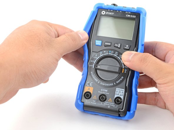

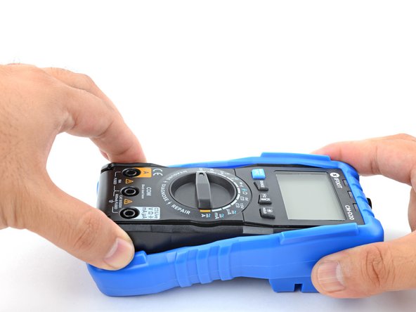

  4. iFixit Digital Multimeter Outer Cover Replacement: 步骤 4 中的图像 1,2 iFixit Digital Multimeter Outer Cover Replacement: 步骤 4 中的图像 2,2
    • Pull the bottom of the cover away from the multimeter to loosen it.
  5. iFixit Digital Multimeter Outer Cover Replacement, Remove the cover: 步骤 5 中的图像 1,3 iFixit Digital Multimeter Outer Cover Replacement, Remove the cover: 步骤 5 中的图像 2,3 iFixit Digital Multimeter Outer Cover Replacement, Remove the cover: 步骤 5 中的图像 3,3
    • Grasp the sides of the cover near the top to hold it in place.
    • Grasp the bottom edge of the multimeter and pull it out at a shallow angle to remove it from the cover.
    • During reassembly, follow this guide to properly clip the cover back in place.
