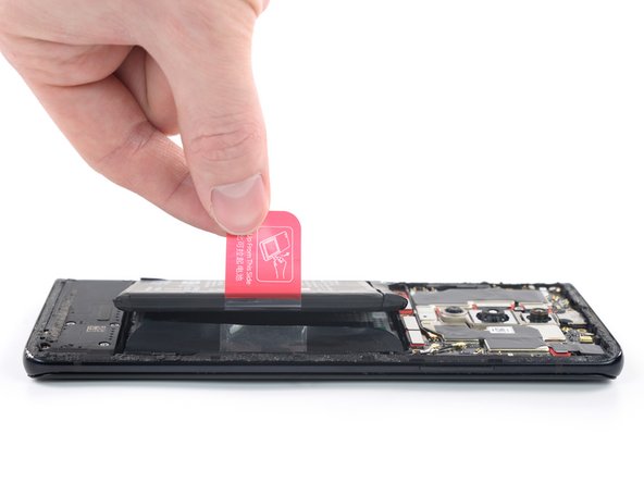

  14. OnePlus 8 Battery Replacement, Lift up the battery: 步骤 14 中的图像 1,3 OnePlus 8 Battery Replacement, Lift up the battery: 步骤 14 中的图像 2,3 OnePlus 8 Battery Replacement, Lift up the battery: 步骤 14 中的图像 3,3
    • The battery is secured to the frame with adhesive. Pull tabs are provided to separate the adhesive and remove the battery.
    • Peel the red pull tab away from the top of the battery.
    • Using one hand to hold the phone steady, use your other hand to slowly and steadily lift the red pull tab up to separate the adhesive securing the battery underneath.
    • If you're having trouble removing the battery, you can apply an iOpener to the screen side to loosen the adhesive underneath the battery.

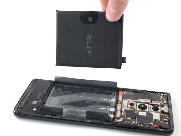

  15. OnePlus 8 Battery Replacement, Remove the battery: 步骤 15 中的图像 1,3 OnePlus 8 Battery Replacement, Remove the battery: 步骤 15 中的图像 2,3 OnePlus 8 Battery Replacement, Remove the battery: 步骤 15 中的图像 3,3
    • Never reuse a deformed or damaged battery—it's a fire hazard. Replace it with a new battery.
    • Peel the battery away from the extra tape on its left edge and remove it.
    • During reassembly:
    • Temporarily reconnect the battery to the motherboard before you press it into place to ensure correct alignment. Disconnect the battery after it's seated.
    • Secure the new battery with pre-cut adhesive or double-sided adhesive tape. In order to position it correctly, apply the new adhesive into the frame where the old adhesive was located, not directly onto the battery itself.
    • Press the new battery firmly into place to secure it.
