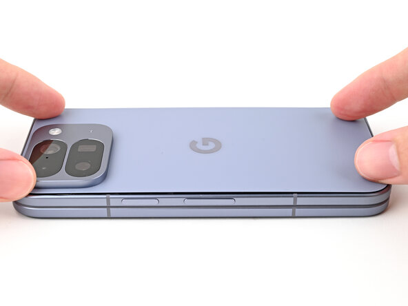

  2. Google Pixel 10 Pro Fold Inner Screen Assembly Replacement, Insert an opening pick: 步骤 2 中的图像 1,3 Google Pixel 10 Pro Fold Inner Screen Assembly Replacement, Insert an opening pick: 步骤 2 中的图像 2,3 Google Pixel 10 Pro Fold Inner Screen Assembly Replacement, Insert an opening pick: 步骤 2 中的图像 3,3
    • Apply a suction cup to the back cover, as close to the center of the bottom edge as possible.
    • While securing the phone with one hand, pull up on the suction cup with strong, steady force to create a gap between the back cover and the frame.
    • Insert an opening pick into the gap.
    • If your back cover is badly cracked, covering it with a layer of clear packing tape may allow the suction cup to adhere. Alternatively, very strong tape may be used instead of the suction cup. If all else fails, you can superglue the suction cup to the broken back cover.

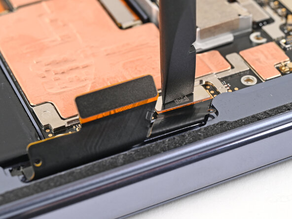

  9. Google Pixel 10 Pro Fold Inner Screen Assembly Replacement, Disconnect the back cover cable: 步骤 9 中的图像 1,2 Google Pixel 10 Pro Fold Inner Screen Assembly Replacement, Disconnect the back cover cable: 步骤 9 中的图像 2,2
    • When disconnecting press connectors, pry only at the gold outlines on the logic board.
    • Don't insert your spudger anywhere else, as you risk dislodging surface‑mounted components.
    • Use the point of a spudger to pry up and disconnect the back cover cable.

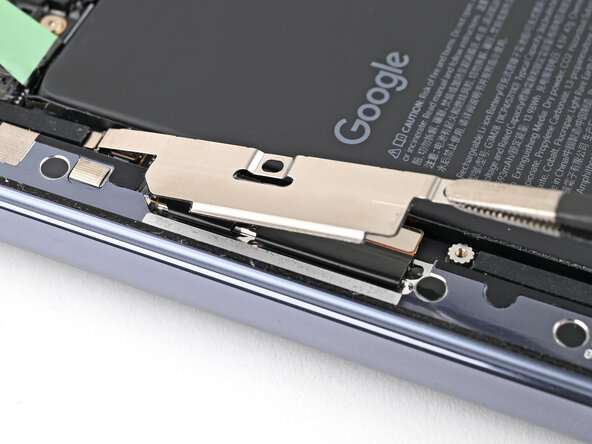

  18. Google Pixel 10 Pro Fold Inner Screen Assembly Replacement, Remove the antenna bracket screws: 步骤 18 中的图像 1,2 Google Pixel 10 Pro Fold Inner Screen Assembly Replacement, Remove the antenna bracket screws: 步骤 18 中的图像 2,2
    • Use a Torx Plus 3IP driver to remove the three screws securing the antenna bracket:
    • One 1.9 mm‑long screw
    • Two 2.8 mm‑long screws
  19. Google Pixel 10 Pro Fold Inner Screen Assembly Replacement, Remove the antenna bracket: 步骤 19 中的图像 1,3 Google Pixel 10 Pro Fold Inner Screen Assembly Replacement, Remove the antenna bracket: 步骤 19 中的图像 2,3 Google Pixel 10 Pro Fold Inner Screen Assembly Replacement, Remove the antenna bracket: 步骤 19 中的图像 3,3

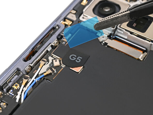

    • Use the point of a spudger to pry up the antenna bracket and release its two clips from the top and right edges of the frame.
  20. Google Pixel 10 Pro Fold Inner Screen Assembly Replacement, Disconnect the 5G mmWave antenna: 步骤 20 中的图像 1,2 Google Pixel 10 Pro Fold Inner Screen Assembly Replacement, Disconnect the 5G mmWave antenna: 步骤 20 中的图像 2,2
    • Use the point of a spudger to pry up and disconnect the 5G mmWave antenna press connector.
  21. Google Pixel 10 Pro Fold Inner Screen Assembly Replacement, Remove the 5G mmWave antenna: 步骤 21 中的图像 1,3 Google Pixel 10 Pro Fold Inner Screen Assembly Replacement, Remove the 5G mmWave antenna: 步骤 21 中的图像 2,3 Google Pixel 10 Pro Fold Inner Screen Assembly Replacement, Remove the 5G mmWave antenna: 步骤 21 中的图像 3,3
    • Insert the point of a spudger under the left edge of the 5G mmWave antenna.
    • Pry up the antenna to separate its adhesive and remove it.

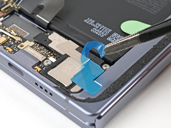

  33. Google Pixel 10 Pro Fold Inner Screen Assembly Replacement, Disconnect the side buttons: 步骤 33 中的图像 1,2 Google Pixel 10 Pro Fold Inner Screen Assembly Replacement, Disconnect the side buttons: 步骤 33 中的图像 2,2
    • Use tweezers, or your fingers, to peel off the yellow tape on the side button cable ZIF connector.
    • Set the tape aside. You'll need it during reassembly.

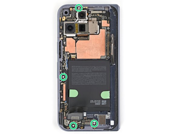

  36. Google Pixel 10 Pro Fold Inner Screen Assembly Replacement, Remove the logic board screws: 步骤 36 中的图像 1,2 Google Pixel 10 Pro Fold Inner Screen Assembly Replacement, Remove the logic board screws: 步骤 36 中的图像 2,2
    • Use a Torx Plus 3IP driver to remove the four 2.8 mm‑long screws securing the logic board.

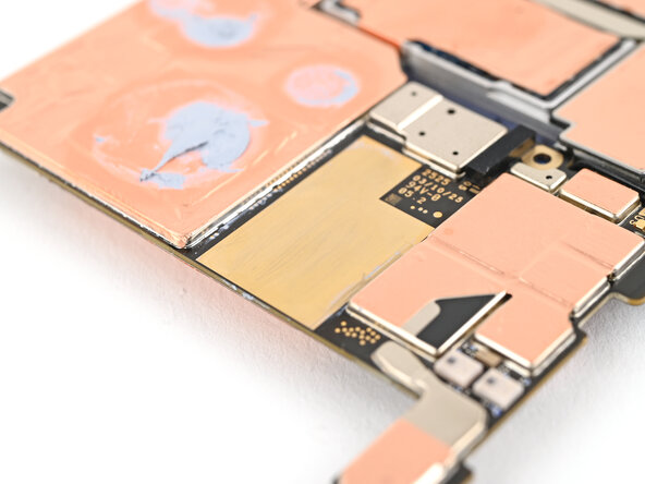

  39. Google Pixel 10 Pro Fold Inner Screen Assembly Replacement, Remove the old thermal paste: 步骤 39 中的图像 1,3 Google Pixel 10 Pro Fold Inner Screen Assembly Replacement, Remove the old thermal paste: 步骤 39 中的图像 2,3 Google Pixel 10 Pro Fold Inner Screen Assembly Replacement, Remove the old thermal paste: 步骤 39 中的图像 3,3
    • Use the flat end of a spudger to scrape off all of the thermal paste from the frame.
    • Apply isopropyl alcohol (>90%) and use a coffee filter or microfiber cloth to clean any thermal paste residue.
  40. Google Pixel 10 Pro Fold Inner Screen Assembly Replacement: 步骤 40 中的图像 1,3 Google Pixel 10 Pro Fold Inner Screen Assembly Replacement: 步骤 40 中的图像 2,3 Google Pixel 10 Pro Fold Inner Screen Assembly Replacement: 步骤 40 中的图像 3,3
    • Repeat the previous step to remove thermal paste on the back of the logic board.

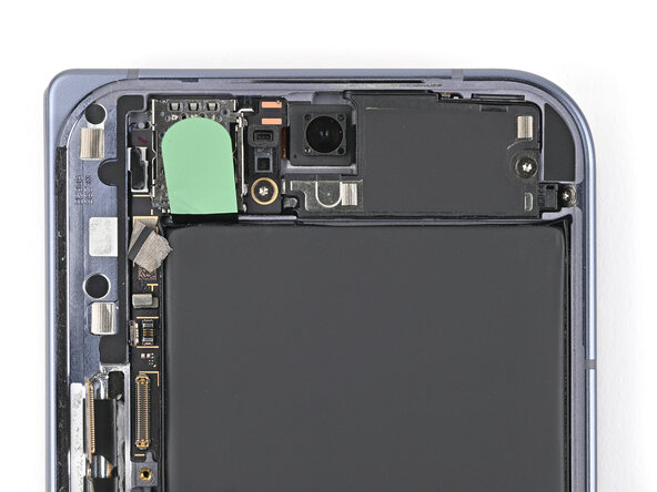

  41. Google Pixel 10 Pro Fold Inner Screen Assembly Replacement, Place the back cover: 步骤 41 中的图像 1,1
    • Place the back cover on the frame to protect the base battery while working on the flipside of the phone.

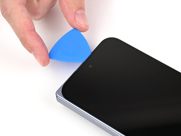

  42. Google Pixel 10 Pro Fold Inner Screen Assembly Replacement, Insert an opening pick: 步骤 42 中的图像 1,3 Google Pixel 10 Pro Fold Inner Screen Assembly Replacement, Insert an opening pick: 步骤 42 中的图像 2,3 Google Pixel 10 Pro Fold Inner Screen Assembly Replacement, Insert an opening pick: 步骤 42 中的图像 3,3
    • Apply a suction cup to the screen, as close to the center of the bottom edge as possible.
    • Pull up on the suction cup with strong, steady force to create a gap between the screen and the frame.
    • If your screen is badly cracked, covering it with a layer of clear packing tape may allow the suction cup to adhere. Alternatively, very strong tape may be used instead of the suction cup. If all else fails, you can superglue the suction cup to the screen.

  52. Google Pixel 10 Pro Fold Inner Screen Assembly Replacement, Remove the conductive fabric: 步骤 52 中的图像 1,3 Google Pixel 10 Pro Fold Inner Screen Assembly Replacement, Remove the conductive fabric: 步骤 52 中的图像 2,3 Google Pixel 10 Pro Fold Inner Screen Assembly Replacement, Remove the conductive fabric: 步骤 52 中的图像 3,3
    • Use tweezers to remove the conductive fabric over the interconnect cable bracket.
  53. Google Pixel 10 Pro Fold Inner Screen Assembly Replacement, Remove the interconnect cable bracket screws: 步骤 53 中的图像 1,2 Google Pixel 10 Pro Fold Inner Screen Assembly Replacement, Remove the interconnect cable bracket screws: 步骤 53 中的图像 2,2
    • Use a Torx Plus 3IP driver to remove the two 2.8 mm‑long screws securing the interconnect cable bracket.
  54. Google Pixel 10 Pro Fold Inner Screen Assembly Replacement, Remove the interconnect cable bracket: 步骤 54 中的图像 1,3 Google Pixel 10 Pro Fold Inner Screen Assembly Replacement, Remove the interconnect cable bracket: 步骤 54 中的图像 2,3 Google Pixel 10 Pro Fold Inner Screen Assembly Replacement, Remove the interconnect cable bracket: 步骤 54 中的图像 3,3
    • Use tweezers to pull the interconnect cable bracket towards the bottom edge of the phone to release its clip.
    • Lift the bracket straight up out of its slot in the frame and remove it.

  59. Google Pixel 10 Pro Fold Inner Screen Assembly Replacement, Remove the lower board: 步骤 59 中的图像 1,2 Google Pixel 10 Pro Fold Inner Screen Assembly Replacement, Remove the lower board: 步骤 59 中的图像 2,2
    • Use the point of a spudger to pry up the bottom right corner of the lower board until it's slightly above the edge of the frame.
  60. Google Pixel 10 Pro Fold Inner Screen Assembly Replacement: 步骤 60 中的图像 1,2 Google Pixel 10 Pro Fold Inner Screen Assembly Replacement: 步骤 60 中的图像 2,2
    • Use the point of a spudger to pry up the bottom left corner of the lower board and lift it out of its alignment peg.
  61. Google Pixel 10 Pro Fold Inner Screen Assembly Replacement: 步骤 61 中的图像 1,3 Google Pixel 10 Pro Fold Inner Screen Assembly Replacement: 步骤 61 中的图像 2,3 Google Pixel 10 Pro Fold Inner Screen Assembly Replacement: 步骤 61 中的图像 3,3
    • Slide an opening pick down the long section of the lower board to separate the adhesive securing it to the frame.
    • Remove the lower board.

  85. Google Pixel 10 Pro Fold Inner Screen Assembly Replacement, Adhere the pull tab: 步骤 85 中的图像 1,2 Google Pixel 10 Pro Fold Inner Screen Assembly Replacement, Adhere the pull tab: 步骤 85 中的图像 2,2
    • Use a spudger to press the green tab near the SIM card tray against the edge of the flip battery well.
    • Slide the spudger across the green tab to smooth out and adhere it against the SIM card tray.

  98. Google Pixel 10 Pro Fold Inner Screen Assembly Replacement, Install the interconnect cable bracket screws: 步骤 98 中的图像 1,2 Google Pixel 10 Pro Fold Inner Screen Assembly Replacement, Install the interconnect cable bracket screws: 步骤 98 中的图像 2,2
    • Use a Torx Plus 3IP driver to install the two 2.8 mm‑long screws securing the interconnect cable bracket.
  99. Google Pixel 10 Pro Fold Inner Screen Assembly Replacement, Compare your new conductive fabric: 步骤 99 中的图像 1,2 Google Pixel 10 Pro Fold Inner Screen Assembly Replacement, Compare your new conductive fabric: 步骤 99 中的图像 2,2
    • Before removing any liners, check that both of your conductive fabric matches the size and shape of the interconnect cable bracket.
    • The clear liner should face the frame.
  100. Google Pixel 10 Pro Fold Inner Screen Assembly Replacement, Remove the old adhesive: 步骤 100 中的图像 1,1
    • If there's adhesive residue on the interconnect cable bracket, use isopropyl alcohol (>90%) and a lint-free cloth to remove it.
  101. Google Pixel 10 Pro Fold Inner Screen Assembly Replacement, Apply the new conductive fabric: 步骤 101 中的图像 1,3 Google Pixel 10 Pro Fold Inner Screen Assembly Replacement, Apply the new conductive fabric: 步骤 101 中的图像 2,3 Google Pixel 10 Pro Fold Inner Screen Assembly Replacement, Apply the new conductive fabric: 步骤 101 中的图像 3,3
    • Peel off the conductive fabric from its clear liner.
    • Align the fabric with the outer edge of the interconnect cable and the white outline on the frame.
    • Press the fabric to the bracket, making sure it overlaps onto the frame.
  102. Google Pixel 10 Pro Fold Inner Screen Assembly Replacement: 步骤 102 中的图像 1,2 Google Pixel 10 Pro Fold Inner Screen Assembly Replacement: 步骤 102 中的图像 2,2
    • Use the flat end of a spudger, or your fingers, to press down the conductive fabric and adhere it to the frame.
  103. Google Pixel 10 Pro Fold Inner Screen Assembly Replacement: 步骤 103 中的图像 1,2 Google Pixel 10 Pro Fold Inner Screen Assembly Replacement: 步骤 103 中的图像 2,2
    • Remove the large blue liner on top of the conductive fabric.
  104. Google Pixel 10 Pro Fold Inner Screen Assembly Replacement: 步骤 104 中的图像 1,3 Google Pixel 10 Pro Fold Inner Screen Assembly Replacement: 步骤 104 中的图像 2,3 Google Pixel 10 Pro Fold Inner Screen Assembly Replacement: 步骤 104 中的图像 3,3
    • Use tweezers to peel off the blue pull tab underneath the lip of the conductive fabric.
  105. Google Pixel 10 Pro Fold Inner Screen Assembly Replacement: 步骤 105 中的图像 1,2 Google Pixel 10 Pro Fold Inner Screen Assembly Replacement: 步骤 105 中的图像 2,2
    • Use the flat end of a spudger, or your fingers, to press down the conductive fabric and adhere it to the interconnect cable bracket.

    • Use the point of a spudger to pry up the segmented tab on the bottom edge of the large blue liner.
  116. Google Pixel 10 Pro Fold Inner Screen Assembly Replacement: 步骤 116 中的图像 1,3 Google Pixel 10 Pro Fold Inner Screen Assembly Replacement: 步骤 116 中的图像 2,3 Google Pixel 10 Pro Fold Inner Screen Assembly Replacement: 步骤 116 中的图像 3,3
    • Lift the tab and peel off the large blue liner to expose the secondary liner.
    • If any of the adhesive starts to peel up with the liner, gently lay it back on the frame and use the flat end of a spudger to secure it to the frame.

  134. Google Pixel 10 Pro Fold Inner Screen Assembly Replacement, Apply the thermal paste: 步骤 134 中的图像 1,3 Google Pixel 10 Pro Fold Inner Screen Assembly Replacement, Apply the thermal paste: 步骤 134 中的图像 2,3 Google Pixel 10 Pro Fold Inner Screen Assembly Replacement, Apply the thermal paste: 步骤 134 中的图像 3,3
    • Apply thermal paste (seven total) to the motherboard in the same locations as the old thermal paste:
    • Five small beads of thermal paste
    • Two larger, "pea-sized" beads of thermal paste

  148. Google Pixel 10 Pro Fold Inner Screen Assembly Replacement, Place the 5G mmWave antenna: 步骤 148 中的图像 1,2 Google Pixel 10 Pro Fold Inner Screen Assembly Replacement, Place the 5G mmWave antenna: 步骤 148 中的图像 2,2
    • Place the 5G mmWave antenna into its slot in the frame.
  149. Google Pixel 10 Pro Fold Inner Screen Assembly Replacement: 步骤 149 中的图像 1,2 Google Pixel 10 Pro Fold Inner Screen Assembly Replacement: 步骤 149 中的图像 2,2
    • Use a spudger to press the antenna down into its thermal pad so it sits flat in the frame.

  169. Google Pixel 10 Pro Fold Inner Screen Assembly Replacement, Apply the G5 sticker: 步骤 169 中的图像 1,3 Google Pixel 10 Pro Fold Inner Screen Assembly Replacement, Apply the G5 sticker: 步骤 169 中的图像 2,3 Google Pixel 10 Pro Fold Inner Screen Assembly Replacement, Apply the G5 sticker: 步骤 169 中的图像 3,3
  170. Google Pixel 10 Pro Fold Inner Screen Assembly Replacement: 步骤 170 中的图像 1,2 Google Pixel 10 Pro Fold Inner Screen Assembly Replacement: 步骤 170 中的图像 2,2
    • Remove the blue liner from the G5 sticker.
  171. Google Pixel 10 Pro Fold Inner Screen Assembly Replacement, Connect the base battery: 步骤 171 中的图像 1,1
    • Reconnect the base battery press connector.

  185. Google Pixel 10 Pro Fold Inner Screen Assembly Replacement, Reconnect the back cover cable: 步骤 185 中的图像 1,2 Google Pixel 10 Pro Fold Inner Screen Assembly Replacement, Reconnect the back cover cable: 步骤 185 中的图像 2,2
    • While holding the back cover or propping it up, reconnect the back cover cable.
  186. Google Pixel 10 Pro Fold Inner Screen Assembly Replacement, Place the top bracket: 步骤 186 中的图像 1,3 Google Pixel 10 Pro Fold Inner Screen Assembly Replacement, Place the top bracket: 步骤 186 中的图像 2,3 Google Pixel 10 Pro Fold Inner Screen Assembly Replacement, Place the top bracket: 步骤 186 中的图像 3,3
    • Place the top bracket into its spot in the frame.
  187. Google Pixel 10 Pro Fold Inner Screen Assembly Replacement: 步骤 187 中的图像 1,2 Google Pixel 10 Pro Fold Inner Screen Assembly Replacement: 步骤 187 中的图像 2,2
    • Use a spudger or your finger to push the bracket upwards and slide its clip under the top edge of the frame.
  188. Google Pixel 10 Pro Fold Inner Screen Assembly Replacement, Install the top bracket screws: 步骤 188 中的图像 1,2 Google Pixel 10 Pro Fold Inner Screen Assembly Replacement, Install the top bracket screws: 步骤 188 中的图像 2,2
    • Use a Torx Plus 3IP driver to install the three 3.0 mm‑long screws securing the top bracket.

    • Align the back cover over the frame and press it into place.
  193. Google Pixel 10 Pro Fold Inner Screen Assembly Replacement: 步骤 193 中的图像 1,2 Google Pixel 10 Pro Fold Inner Screen Assembly Replacement: 步骤 193 中的图像 2,2
    • Press along the perimeter of the back cover to adhere it to the frame.
    • Optionally, you can use a hair dryer or heat gun to lightly heat the edges of the back cover and create a stronger bond.
    • Let the phone sit a few hours for the adhesive to cure.
