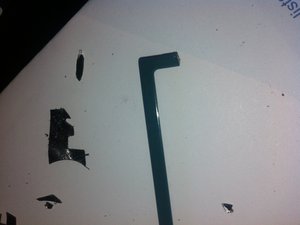

While trying to replace the creen on an ipoD touch screen, I was removing the mainboard/logic board when I accidentally snapped the long cable like edge of the board. Will this affect the iPod? Is there anything at all I can do?

can you take a photo of the part you have damaged? The closer the better. To add the photo you need to click on the orange tab, bottom left "images", upload and then click and drag to the answer section. It will then prompt you to select "update" your question..at this time you can't add photo's to a comment.

My logic board

Ciaran Talbot, this looks like some major damage. From what I can see on those pictures, you would require a new board. You might try to remove some of the shellac like coating with very fine emery cloth on both surfaces. Once you got that you can try and epoxy the actuwl board and use a trace pen to connect the trace. Now if you are really good, and have the right tools you could solder a bridge across the broken trace. This is best done with a controllable soldering iron, a stereo microscope and lots of practice. Best to replace the board. Just my 2cents. good luck.
