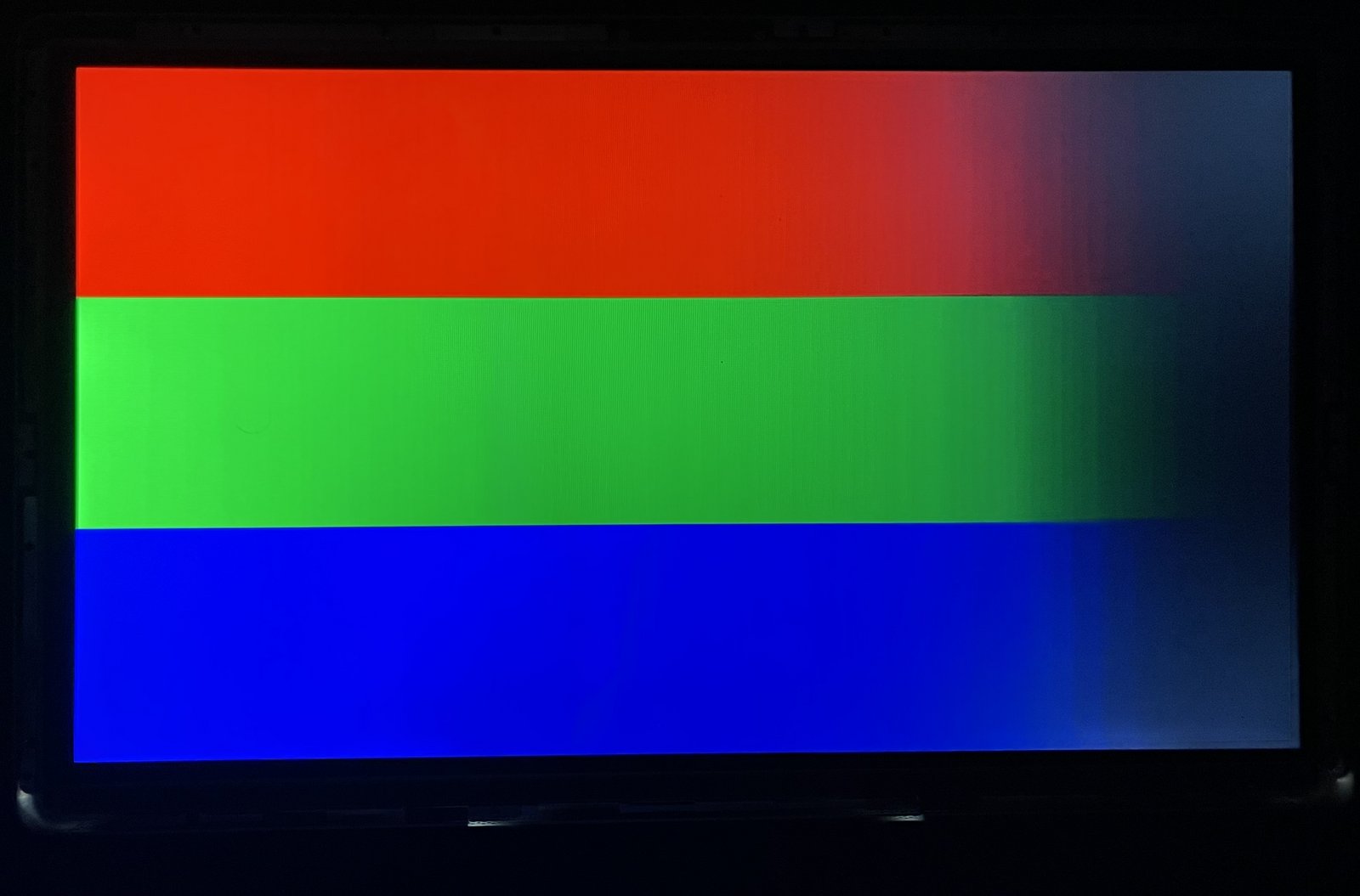

I picked up an inoperable A1316 with what turned out to be a backlight issue. I was able to resolder the LED backlight connector onto the existing LED strip and reassemble the display. Everything seems to be working properly but unfortunately the picture seems a bit too white/washed out (hard to see in the attached pic). While doing the repairs the diffuser panels got separated and I had not previously noted the order they go in. I thought I had figured out how to reassemble them but now I’m thinking it’s possible that I put them back in out of order. It’s also very possible that the extra light is due to the fact that I have not replaced the aluminum tape yet, but I wanted to make sure everything was in order before taping it back up. So I was wondering if anybody could please let me know the correct order of the diffuser panels so I can have some peace of mind before taping everything back up?

@ericsacks It'll depend on how many sheets yours has. The one I'd work on had a piece of (start from the backlight) Plexiglas followed by a diffuser then a Fresnel lens and finally the polarizer. Yours actual looks properly assembled. You will notice immediately when your sheets are messed up. The light bleed could come from the plastic frame where the LCD assembly sits in. Make sure it is properly/straight assembled. Again, your issue are not your diffuser sheets.

@oldturkey03 Thank you for the reply! So if I’m understanding you correctly, the order and numbers of diffusers vary by display? I don’t know what a fresnel lens or polarizer are nor what they look like, but I think you are probably correct that mine seem to be in the correct order. I believe the order I put them in was a diffuser, followed by plexiglass, then either a diffuser followed by a silver sheet (shiny side down) or possibly just the silver sheet on top of the plexiglass, I don’t quite remember, then one more diffuser before the LCD. I have added a number of test screens to this posting, could you please take a look and let me know if things look as should be expected (assuming that I have yet to re-tape the display to try to curb the leaking)? Please note that the 1st pic is supposed to be a BLACK background….
由完成的
@ericsacks “numbers of diffusers vary by display” more by manufacturer and technology. It does look it is right. Do you remember if your plexiglass was clear or if it was milky white? As for the bleeding, yes, if the diffuser sheets are just slightly bowed, the light will leak. It is absolutely possible that reapplying the tape will fix this.

@ericsacks - The additional images help a lot! The sheets locations do appear in the correct order, but the sheets are not laying flat which is why the corners are over saturated in your >Black< first image. Even my 27” has this now from age not as much as yours though and not uncommon on LCD screens. Zoned backlighting improves this but can create a halo effect. OLED screens don’t encounter this issue, but have other issues with burn-in over time.
I still see a bit of light bleed but likely that’s the edge seal that is still missing.
As to the sheets using a magnifier you can identify the prismatic sheet and using a pair of polarized sunglasses you can identify the polarizer sheet.
