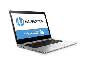

Is the RAM upgradeable?
I wanted to upgrade the RAM, but I can’t find it in the laptop. Is it on the MB?

@goodlucknelson Check the answers. The short answer is that you can't. The RAM is soldered onto the board, making it a extremely difficult replacement process. Not impossible, just not worth the risks.

HPs documentation indicates that the RAM on this model is soldered onto the board. So for all intents and purposes, no it is not user upgradeable.

What if the RAM fail? My computer RAM Failed but not removable
由完成的 分享
@Biruk Ayele You might be able to find a repair technician who does board level repairs that can diagnose the issue and replace either the RAM chips themselves, or whatever faulty component is causing the problem.
Otherwise you'll have to replace the system board to restore functionality.

This seems to be factory configured
“About your EliteBook x360 1030 G2
Your computer's memory capability:
Standard memory:
4GB to 16GB non-removable”

"The HP EliteBook x360 1030 G2 comes with 8GB DDR4 RAM on board, and there is no spare RAM slot, so you can not upgrade the RAM."
由完成的 分享
HP EliteBook x360 1030 G2 Disassembly (SSD, RAM Upgrade Options)
A pretty detailed tear down https://www.laptopmain.com/hp-elitebook-...

Nope, it's on the MB.
