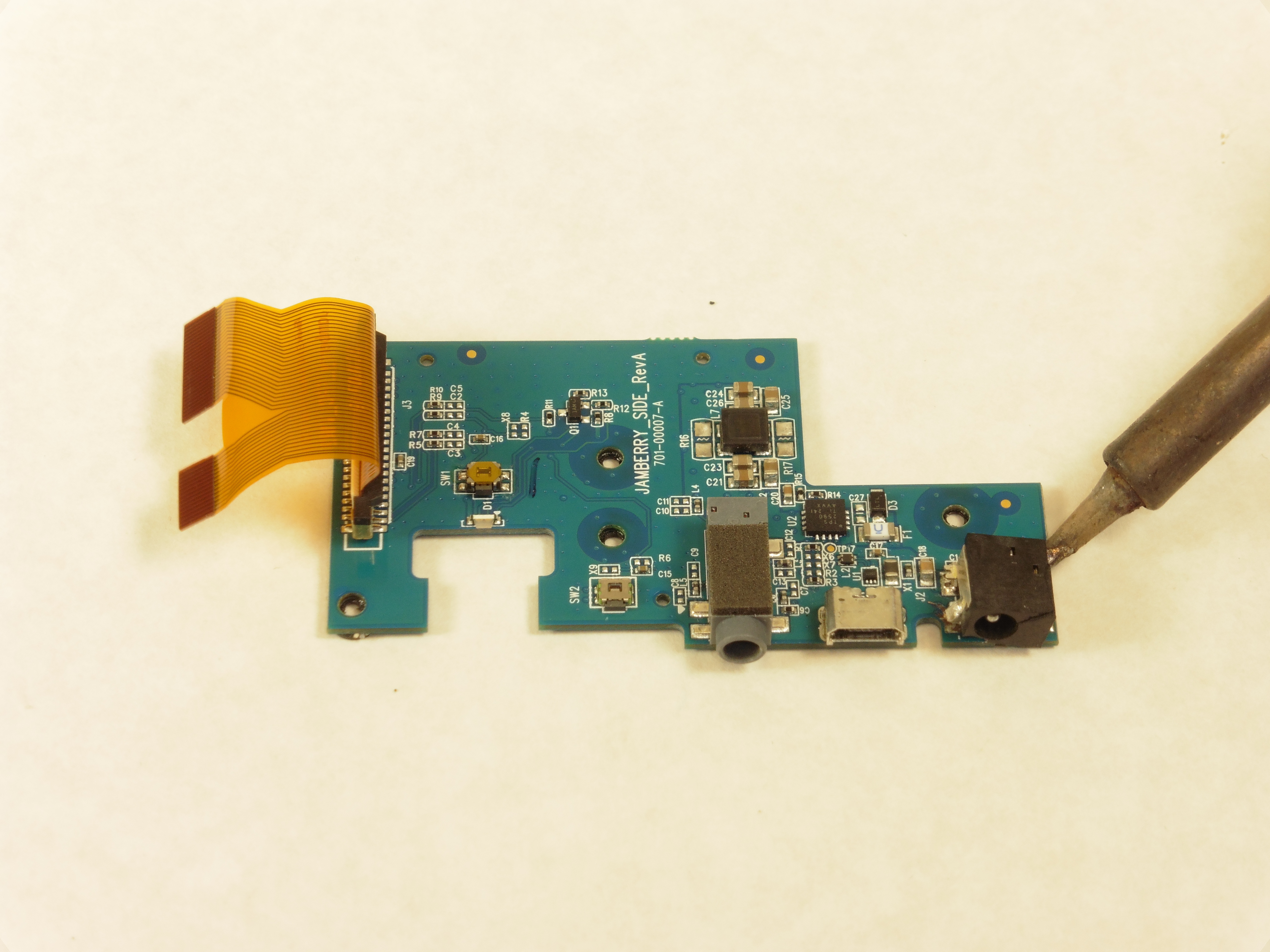

How can I fix/replace the pairing button?
The soft rubber part of the pairing button tore apart when it was pressed too hard with a sharp instrument, and now it seems that the button mechanism on the inside is broken since I am not able to press the button anymore at all. There is an empty space where the button used to be. I have not attempted any repair or taken anything apart yet. I was hoping that this could be fixed. Thank you very much for any help you can give me. R

I followed the steps to open up the Jambox. The pairing button does not seem to be intact. All that I have is a small loose plastic piece about 1/8" long that does not look like it would work to push anything near the pairing switch (SW2).

The SW2 switch for pairing is gone. Must have become dislodged from the circuit board. Anyone know where I can order that particular SW2 pairing switch. Thank you kindly.

Hi,
Here is the Ifixit link which shows how to replace the charge port on a Jam Box. It is on the charge port board you will find the pairing switch (SW2)
Jawbone Big Jambox 充电口更换
This link taken from the above link shows the pairing switch (marked SW2,- to the right of the slot cut in the bottom of the board as viewed in the picture), on the board. From your description it seems as though the actuating lever for the switch has been pushed out of the way, as in the picture it seems as though it is a normal push button type switch. You may have to figure out (if the switch is still connected to the board), whether you are either going to replace it with a switch with a longer actuating lever to reach the outside of the case or to either fix or replace the extending switch operating mechanism that is there now.
https://d3nevzfk7ii3be.cloudfront.net/ig...
hopefully this is of some help.

Does the small plastic piece look like it is 'broken' off? If so are there any other pieces lying around in the bottom of the player? In Step #7 of the guide above the pairing button seems to be a round push type. Does it have a slot into which an operating rod could be inserted, which would hold/guide the piece of plastic?
If possible, before you go to all the trouble of figuring out how to fix the operation of the switch, prove that the pairing function still works by pressing the switch (SW2) (with the unit assembled enough to be turned on - use a suitable non metallic probe of some description e.g. handle of a thin paint brush or the end of a plastic pen).
If it still works and you are not to worried about looks and the existing button offers no solution, perhaps a small access hole through which you can insert a probe to operate the switch may be good enough. It might depend on how often you wish to pair the speaker.
