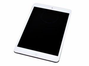

I have ran into a few iPad Minis now where the power button will not put the device to sleep. I have replaced the power flex cable and still have the same result.
If you hold the button down the device will power on or off like normal. Just the sleep function doesn't work.
Any ideas?

Did you try to toggle the "lock/unlock" button under Settings>General>Lock/Unlock?
EDIT: as odd as it sounds, it is usually a bad quality digitizer (outer glass) assembly. Get a good one from a reputable seller and it will be fixed.
The home button circuit is interfacing with a circuit built into the digitizer assembly. A bad quality or defective assembly will therefore cause the power ON/OFF button to stop working.

Sorry I missed this question for a few days. This is a problem with soldering at home flex. Yes, home flex. It is common with the aftermarket digitizers. Get a new original quality digitizer and it will solve.

If you have a low quality Chinese screen you could try this. It worked for me on an iPad mini 2.
Go to settings
display and brightness
Lock/unlock.
Toggle the switch to off ( no green visible).
And that's it.
As a second fix, it also allows apps to be deleted where before they could not even though the X in the top left was present.
