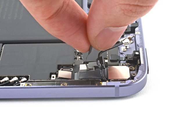

  20. iPad Mini 6 Power Button Replacement, Reposition the power button board's cable: 步骤 20 中的图像 1,2 iPad Mini 6 Power Button Replacement, Reposition the power button board's cable: 步骤 20 中的图像 2,2
    • The power button board's cable is lightly adhered to the rear camera's press connector.
    • Gently peel back on the power button board's cable to separate it from the rear camera's press connector.

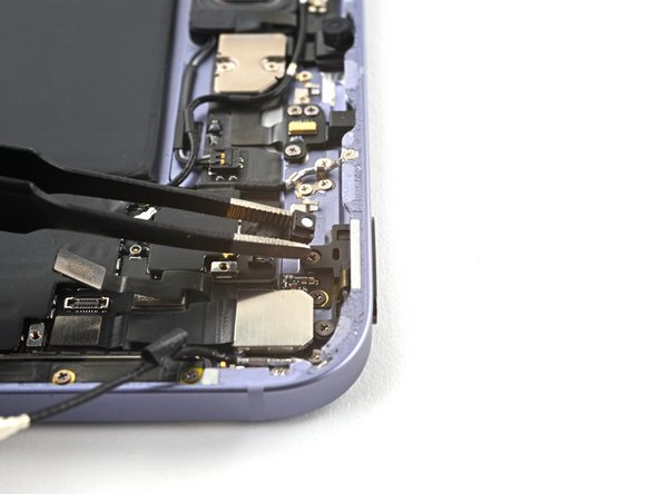

    • Use tweezers, or your fingers, to remove the black tape on top of the power button board's ZIF connector.

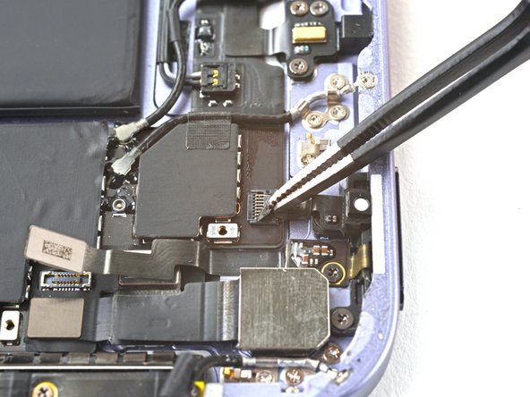

  22. iPad Mini 6 Power Button Replacement, Disconnect the power button board's ZIF connector: 步骤 22 中的图像 1,2 iPad Mini 6 Power Button Replacement, Disconnect the power button board's ZIF connector: 步骤 22 中的图像 2,2
    • Use a spudger, an opening tool, or your fingernail to flip up the small, hinged locking flap on the power button board cable's ZIF connector.
  23. iPad Mini 6 Power Button Replacement: 步骤 23 中的图像 1,2 iPad Mini 6 Power Button Replacement: 步骤 23 中的图像 2,2
    • Use a pair of tweezers to pull the power button board's cable straight out of its ZIF connector on the frame.
  24. iPad Mini 6 Power Button Replacement, Remove the cable: 步骤 24 中的图像 1,2 iPad Mini 6 Power Button Replacement, Remove the cable: 步骤 24 中的图像 2,2
    • Use tweezer, or your fingers, to remove the power button cable from the frame.
