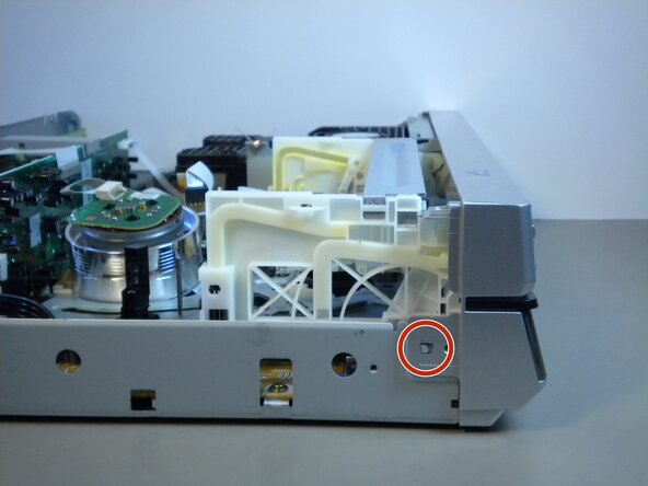

    • With the front display of the device facing you, rotate the device 90 degrees counter clockwise.
    • Remove silver screw and then turn the device 180 degrees. Remove the second silver screw.
