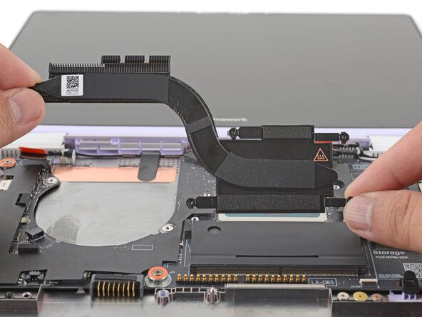

  29. Framework Laptop 12 Mainboard Removal, Loosen the heatsink screws: 步骤 29 中的图像 1,1
    • Use your Framework Screwdriver to loosen the four captive T5 Torx screws securing the heatsink.
  30. Framework Laptop 12 Mainboard Removal, Loosen the heatsink: 步骤 30 中的图像 1,3 Framework Laptop 12 Mainboard Removal, Loosen the heatsink: 步骤 30 中的图像 2,3 Framework Laptop 12 Mainboard Removal, Loosen the heatsink: 步骤 30 中的图像 3,3
    • Slide the flat end of your Framework Screwdriver under the heatsink arm labeled "2".
    • Gently twist the Framework Screwdriver to lift the heatsink arm and loosen the heatsink.
    • You'll feel some resistance from the thermal compound holding the heatsink in place. Stop if the heatsink arm begins to bend.
    • If the heatsink won't budge, make sure you've fully loosened the four screws securing the heatsink.
    • Repeat the procedure with the heatsink arm labeled "3".
  31. Framework Laptop 12 Mainboard Removal, Remove the heatsink: 步骤 31 中的图像 1,2 Framework Laptop 12 Mainboard Removal, Remove the heatsink: 步骤 31 中的图像 2,2
    • Lift and remove the heatsink.
