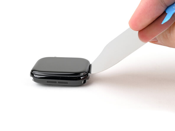

  5. Apple Watch - Series 10 (46mm) Screen Replacement, Insert an iFlex: 步骤 5 中的图像 1,3 Apple Watch - Series 10 (46mm) Screen Replacement, Insert an iFlex: 步骤 5 中的图像 2,3 Apple Watch - Series 10 (46mm) Screen Replacement, Insert an iFlex: 步骤 5 中的图像 3,3
    在这个步骤中使用的工具:
    iFlex Opening Tool
    $11.99
    • The gap between the screen and frame is extremely small. You'll need a thin tool such as an iFlex to create an initial gap.
    • Don't grip the iFlex or similar metal tools by the edges—they're very sharp. Consider wearing gloves to protect your hands.
    • Insert the iFlex at a downward angle between the bottom edge of the screen and frame.

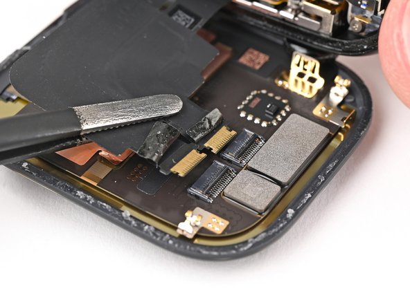

  13. Apple Watch - Series 10 (46mm) Screen Replacement, Peel up the screen cable tape: 步骤 13 中的图像 1,3 Apple Watch - Series 10 (46mm) Screen Replacement, Peel up the screen cable tape: 步骤 13 中的图像 2,3 Apple Watch - Series 10 (46mm) Screen Replacement, Peel up the screen cable tape: 步骤 13 中的图像 3,3
    • Use tweezers to peel up the tape covering the two screen cable ZIF connectors.
  14. Apple Watch - Series 10 (46mm) Screen Replacement, Flip up the locking flaps: 步骤 14 中的图像 1,3 Apple Watch - Series 10 (46mm) Screen Replacement, Flip up the locking flaps: 步骤 14 中的图像 2,3 Apple Watch - Series 10 (46mm) Screen Replacement, Flip up the locking flaps: 步骤 14 中的图像 3,3
    • Use the tip of an opening pick to pry up the small, hinged locking flaps on both screen cable ZIF connectors.
