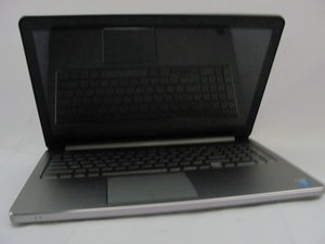

Hi @davidadams86992
What model 7506 do you have?
Asking because according to the specifications the 7506 2 in 1 black edition has integrated memory i.e. non removable.
The 7506 2 in 1 silver edition supports a maximum 16GB DDR4 3200 sodimm ram over two slots i.e. 2 x 8GB.
Here's the service manual for the silver edition model. Go to p.20 to view the procedure to remove/replace the memory modules.
