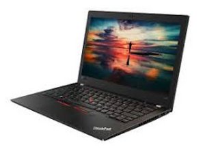

ThinkPad A275(型号:20KD0011)是一款 2017 年发布的 12.5 英寸商务笔记本电脑,配备 AMD 处理器、8GB 内存和 1920x1080 显示屏。
Why my computer fails to boot up
No any sign led light does not light up, charge light does not light up also battery is weak
