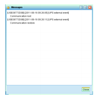

Lately I can't see anything in the ViewPower program and when I contacted BlueWalker support they told me that the problem is the PCBA.
How can I check it to see if it really isn't working?
UPS Model: PowerWalker VI 1000 PSW Schuko
Update (09/08/24)
I have this:
How do I add port to Firewall exclusions in Windows 11?
In order to start, the following screen must appear:
How can I start it automatically?
I solved the problem.

Hi @piero90
If you haven't already done so, here's the S.O.P. How To Check ViewPower Status And Open Port guide that may help.

@piero90
Did the problem only occur after you updated to Win11 (if you did) or not?
Here's a video that may help.
由完成的 分享
I followed the video but nothing
由完成的 分享
@piero90
if the port is "open" and there's no connection with the UPS then most likely it is the UPS unless it is in the wiring/cable etc between the UPS and the PC
由完成的 分享
I must try to change the cable to verify if the problem is UPS
由完成的 分享
