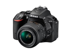

尼康 D5500 是尼康公司于2015年1月5日发布的中端消费级单反相机

live view switch does not work and it blocked the other bottons of the camera what to do ?

Hello, i found the cause of that issue. The LV lever has a push button inside ( top cover part), that was stuck for me. Hitting it with a tweezer freed it again therefore it wasnt “on” all the time. I hope this helps.
