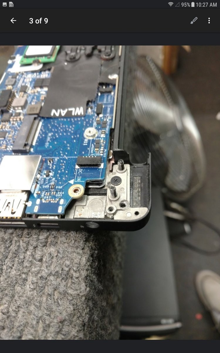

Hi,
My laptop hit the floor and the post that the laptop base hex screw attaches to snapped off. Not a problem, however the laptop keeps separating every time I close the lid and I have to push the top and bottom together to put the laptop to sleep. It’s now causing more internal damage and when I open it up, the clip has snapped off the laptop base as well as the screw hole to the base is also cracked in half. I’ve attached pics but wanted to know the hinge was attached to that I need to replace, as well as the hinge itself. This is on the same side as the power button. Any info would be very much appreciated. And not sure if the pictures uploaded or not but have those too.
Thanks!

Hi @frankralfano ,
You need to replace the palmrest assembly.
Here’s a link to the service manual for a Dell XPS 15 9550 laptop taken from this webpage
Scroll to p.87 to view the necessary pre-requisite steps and then the procedure to remove/replace the palmrest assembly.
Replacements are available online. Just search for Dell XPS 15 9550 palmrest assembly to get results for suppliers of the part.

Have you resolved this yet..? It's what refer to as a “Design Flaw” by Dell.. I've had to engineer a solution for this problem, as I have seen multiple XPS Models with this very same thing happening.. Note: this is on the opposite side of the WLAN Connector, but I would probably handle it the same way… Cheers

Hi Ruben, I really like your solution looks absolutely solid. Can you tell me which and which size screws and bolts you used for this fix please? Did you use any glue as well? Thanks
由完成的 分享
I know this is much later than your posting date, regarding screws and bolts, however maybe someone else viewing this post can be assisted by the answer to your question.
Screws are regular laptop Phillips Head - 2.5mm/3mm/3.5mm sizes (referring to width of course). Because I have thousands of these available in a shop environment, I simply searched for and found the longest screws available (1" to 1.5" length).
For the "bolts" parts of the answer, these are not bolts, but rather the Collettes (screw receptacles encased in plastic, gold or bronze colored) that broke off, and were originally fastened to the factory screws (look at the 4th image and zoom in).
If you don't have 100's or 1000's of Laptop screws around, as I conveniently do, I've seen eBay and Amazon sellers offering multi-packs of these type screws that one can acquire in 2-3 days after shipping, maybe sooner depending upon your locale..
This process I've now had to perform on more than just Dells, but HP's, Acers, Sony, Lenovo, etc.. Works great
由完成的 分享

Glue won't do the trick, as far as re-attaching display hinges to the laptop base/palmrest assembly. Drill some holes, increase the durability beyond that of the original manufacturer's design (which is quite weak in many cases).
Look at the post where I'm referring to this as a "Hands Down DESIGN FLAW" by many manufacturers..
