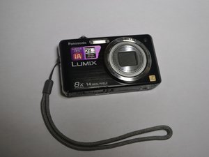

camera does not recognize external sim card
Hello,
Wondering if there is a repair for this camera that is not recognizing the external sim card.?

Hi, same problem in 2023! (I gave this camera for my 3y old daughter). My solution was change the format FAT32 to NTFS. I have inserted the SD card again then the camera recognized and asked my to format and voila, it worked!

Do you mean an SD card? You may need to make sure the card is set for use with cameras, you can fiddle with it in the menu options and card options that your computer allows you to have, then you can set it for camera. Then if you get it in the camera, go to format and it can specify it with the type of camera details and processes.
Update (05/12/25)
Yeah, on the computer right click on the card in the menu. Then go to settings, and program from the information offered. If a person goes into these options backing out will not change anything, so the options can be explored.
