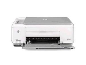

HP Photosmart C3180 是一款多功能一体机。
feeder roller disk alignment during reassembly
mounting the feeder roller is there any adjustment between the sensor in the logic plate with relation to the transparent disk with some square patterns?

Good morning, good guide.
I have a problem after installing the printer.
The printer taking paper but not recognize alignment of it, cartridges not go into place and carriage for cleaning cartridges be fully forward.
How can I fix these problems?
I think that the blame be my little experience, I would not have thought of alignment degrees of roller gear.

Be a precise position of the roller before fitting it? The trolley head cleaning must be all back?

Hello Roberto, I did a general maintenance on my printer (I washed all the plastic casing and sponges from the trash) and went back ... the care I had with the transparent disk, searching the internet, was to place the small marking (colored square) exactly in the position of the sensor ... that's right, inside the sensor, as accurate as possible, but still, my pages are about 2mm wrong, but it's already something. I did not open it again to fix it, but I believe the position is not totally wrong.
