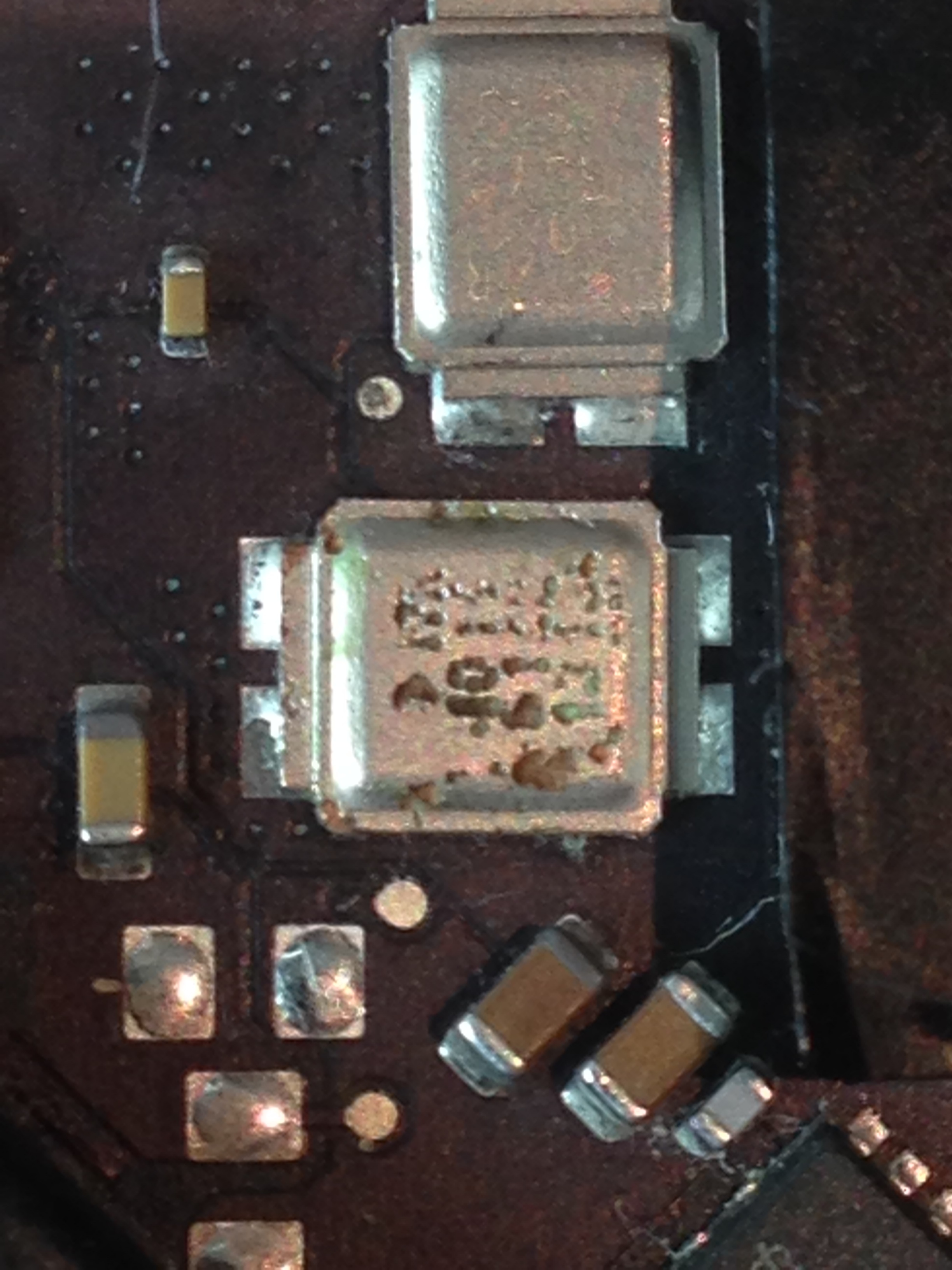

I'm trying to repair the logic board of my MacBook Retina 15 after that it suffered a damage from coffee spill.
Can anybody tell me which smd component is the one in the photo?
http://img89.imageshack.us/img89/4346/im...
Thanks a lot
Cheers,
Alessandro

Looks like a DirectFET Power MOSFET Any chance you can attach an image that shows the marking on the component a bit clearer?

Hi, today I was able to make some very high resolution photos:
http://imageshack.us/f/841/img2636q.jpg/
http://imageshack.us/photo/my-images/834...
http://imageshack.us/photo/my-images/38/...
http://imageshack.us/photo/my-images/818...
The damaged component is from International Rectifier but I cannot spot it anywhere. the part number should be in the first line under the logo, it seems to be something like "1010" but I am not sure. Any ideas?
Any help would be really appreciated, I would like to try to replace this component myself and see if my retina came back to like.

Alessandro, start of with this part marking.
UPDATE
Thanks to fortunato for looking at this questions, otherwise I would have never thought of it again. Anyhow, the component you are looking for is reference designator Q7510 and it is a IRF6802SDTRPBF MOSFET 25V Dual Control FET. The datasheet is available right here. Hope this helps to finally answer this question.

OT - Have you found a source for these odd ball parts Apple uses? Also have you tried to replace these flat-pak SMD devices? Four leads/pads is as far as I can take it with a straight micro iron and a good probe to hold it in place. These look harder to work with.
完成的
Dan, just looked up a similar one from an A1286, it's a IRF9395TRPBF with the datasheet available here http://www.irf.com/product-info/datashee... definitely interesting and sure looks like a PITA to work with. Still trying to find the right one for Alessandro. they are definitely International Rectifier
完成的
Thank you very much for your help.
The logic board has got a black sticker, I suppose it's the serial number you are asking for and it ends with "VAH"
The macbook serial number is printed on the botton of the machine and ends with "DKQ1".
The exact model number of my retina is A1398, it's a 2.3ghz i7 8GB ram 256 ssd.
Component part number is "1010" but it is for sure an OEM part number for Apple, IRF support confirmed that but was not able to tell me more.

OT - Looks like you need to modify the heat gun, creating a concentrator cone to limit the air stream to selectively heat the area. - I had a thought, what if we tried using their online design tool to input the known voltages and see what BOM and circuit it spits out and see it it matches what Apple has. Or, compare their other FET's they use in the other MBP power circuits maybe we can glean a clue that way.

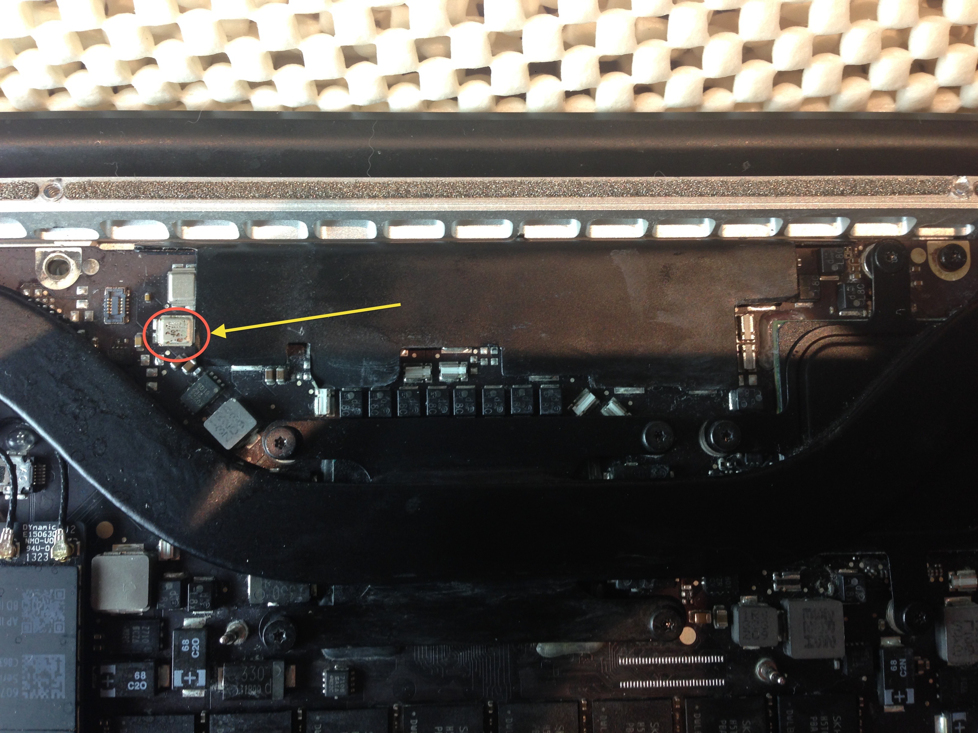

It seems my laptop suffered pretty much the same thing, although the MOSFET is not exactly that one:
[URL|https://d3nevzfk7ii3be.cloudfront.net/ig...]
It is also the same model, although the 16gb model, with the board 8020-3332.
Difference is I can't figure out what is written on it:
It seems to say:
17V or 19V
1014?
61xx?
1313?
My question would be, is this also a IRF6802SDTRPBF MOSFET 25V Dual Control FET? They all look pretty similar :) Thanks!
