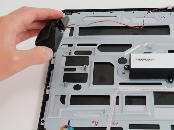

      • Use the plastic opening tool to disconnect the white bundled cable connector that links the left speaker to the motherboard via a red wire.
      • Remove the left speaker by gripping it with your hand and lifting it off of the pegs.

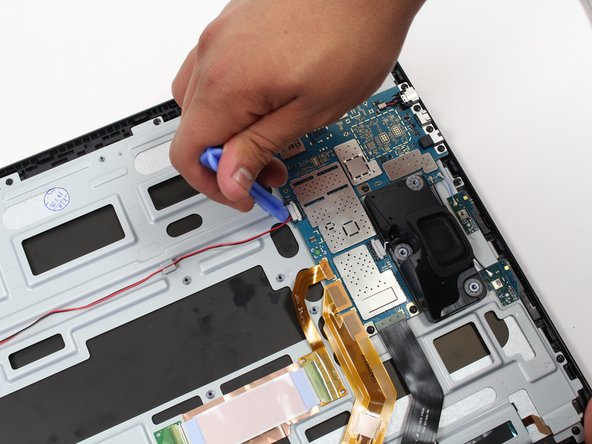

      • Insert the plastic opening tool beneath the orange press-fit connector attached to the bottom left side of the motherboard and use a leverage motion to pry the connector from the board.
      • Repeat the above step for the other two orange press-fit connectors attached on the bottom left side of the motherboard.

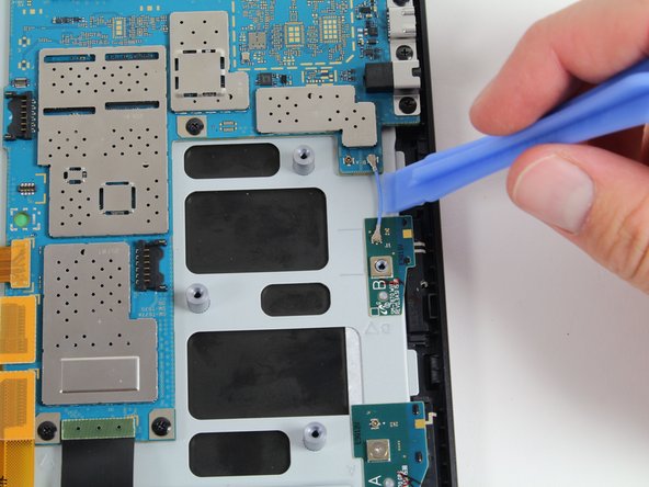

      • Use the plastic opening tool to pry up on the blue antenna cable connector near the right edge of the motherboard.
      • Repeat the above for the black antenna cable connector positioned next to the blue wire.

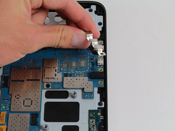

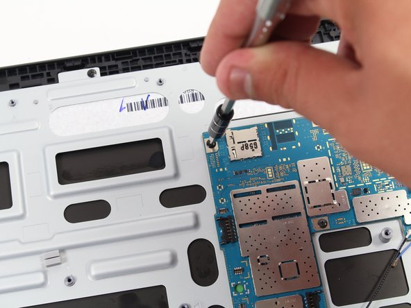

      • Use a Phillips #00 screwdriver to remove the nine 3 mm screws around the motherboard.
      • There is a metal bracket beneath four of the screws on the right side of motherboard. This bracket will also be removed during this step.
      询问修复机器人
      添加评论
    4. Samsung Galaxy View Motherboard Replacement: 步骤 13 中的图像 1,1
      • Lift the motherboard straight up to remove it from the device.
