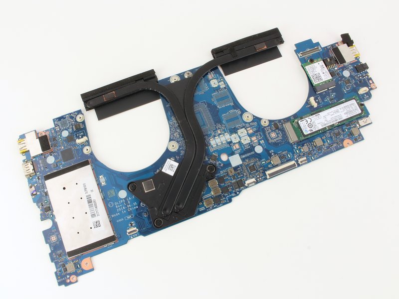

    9. Lenovo YOGA 730-15IKB Motherboard Replacement: 步骤 22 中的图像 1,1
      • Pull the motherboard up out of the laptop chassis.
      • If you are replacing the motherboard, make sure to remove the SSD, wireless card, heat sink, and extra RAM. Transfer these components to the new motherboard.
