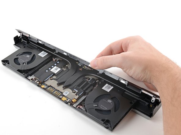

  13. Framework Laptop 16" Graphics Module Fan Replacement, Remove the graphics module cover screws: 步骤 13 中的图像 1,3 Framework Laptop 16" Graphics Module Fan Replacement, Remove the graphics module cover screws: 步骤 13 中的图像 2,3 Framework Laptop 16" Graphics Module Fan Replacement, Remove the graphics module cover screws: 步骤 13 中的图像 3,3
    • Flip over the graphics module so the fans are facing you.
    • Use a T5 Torx screwdriver to remove the four 3.6 mm‑long screws securing the graphics module cover:
    • Two screws on the flat surface of the module, next to the fans.
    • Two screws on the thin edge of the module, near the ends. You'll need to flip the module on its back edge to access them.
  14. Framework Laptop 16" Graphics Module Fan Replacement, Remove the graphics module cover: 步骤 14 中的图像 1,3 Framework Laptop 16" Graphics Module Fan Replacement, Remove the graphics module cover: 步骤 14 中的图像 2,3 Framework Laptop 16" Graphics Module Fan Replacement, Remove the graphics module cover: 步骤 14 中的图像 3,3
    • Use your fingers to lift the graphics module cover off the expansion bay and remove it.

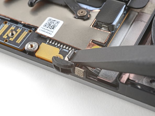

  15. Framework Laptop 16" Graphics Module Fan Replacement, Disconnect the fan: 步骤 15 中的图像 1,2 Framework Laptop 16" Graphics Module Fan Replacement, Disconnect the fan: 步骤 15 中的图像 2,2
    • Use the flat end of a spudger, or a clean fingernail, to lift up and release the locking tab on the fan ZIF connector.
  16. Framework Laptop 16" Graphics Module Fan Replacement: 步骤 16 中的图像 1,2 Framework Laptop 16" Graphics Module Fan Replacement: 步骤 16 中的图像 2,2
    在这个步骤中使用的工具:
    • Use tweezers, or your fingers, to grip the brown pull tab and slide the fan cable straight out of its socket.

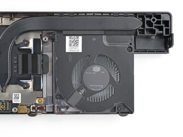

  17. Framework Laptop 16" Graphics Module Fan Replacement, Loosen the fan screws: 步骤 17 中的图像 1,2 Framework Laptop 16" Graphics Module Fan Replacement, Loosen the fan screws: 步骤 17 中的图像 2,2
    • Use a T5 Torx screwdriver to loosen the four captive screws securing the fan.

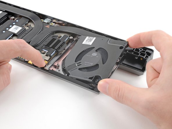

  18. Framework Laptop 16" Graphics Module Fan Replacement, Remove the fan: 步骤 18 中的图像 1,3 Framework Laptop 16" Graphics Module Fan Replacement, Remove the fan: 步骤 18 中的图像 2,3 Framework Laptop 16" Graphics Module Fan Replacement, Remove the fan: 步骤 18 中的图像 3,3
    • Use one hand to press the fan cable flat to the module.
    • Use your other hand to pull the fan out of its housing, making sure to thread the cable though its slot.
    • Remove the fan.
