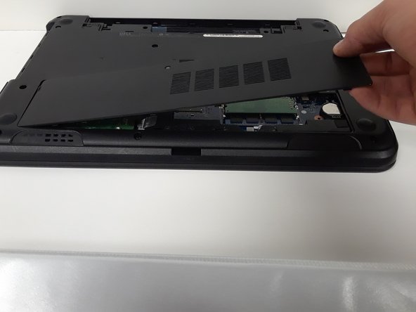

    3. Fast Fix Screen Replacement: 步骤 3 中的图像 1,2 Fast Fix Screen Replacement: 步骤 3 中的图像 2,2
      • Loosen 2 screws on access door.
      • They cannot be removed
      • Remove the access door.
