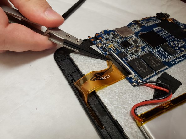

    4. Craig Electronics CMP773 Screen Replacement: 步骤 4 中的图像 1,2 Craig Electronics CMP773 Screen Replacement: 步骤 4 中的图像 2,2
      • Using your finger, remove the clamp that connects the screen power rib to the motherboard.
      • Using needle nose pliers, remove the ribbon.

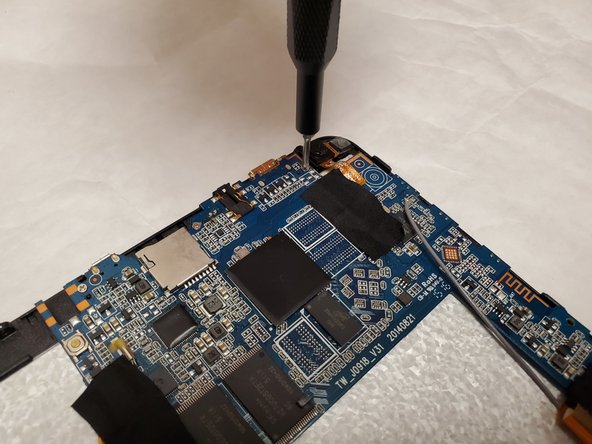

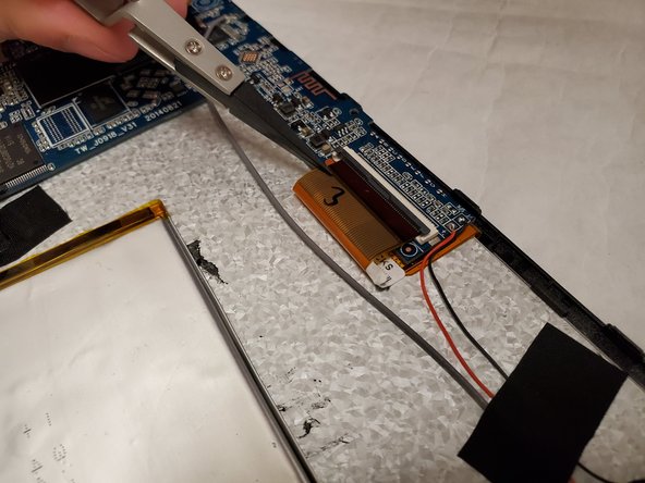

    5. Craig Electronics CMP773 Screen Replacement: 步骤 5 中的图像 1,3 Craig Electronics CMP773 Screen Replacement: 步骤 5 中的图像 2,3 Craig Electronics CMP773 Screen Replacement: 步骤 5 中的图像 3,3
      • Remove the second screen power connection from the motherboard using the same procedure as step 4.

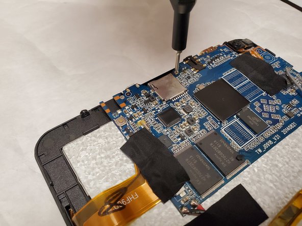

    6. Craig Electronics CMP773 Screen Replacement: 步骤 6 中的图像 1,3 Craig Electronics CMP773 Screen Replacement: 步骤 6 中的图像 2,3 Craig Electronics CMP773 Screen Replacement: 步骤 6 中的图像 3,3
      • Remove four screws from the motherboard using the Phillips #00 screwdriver.

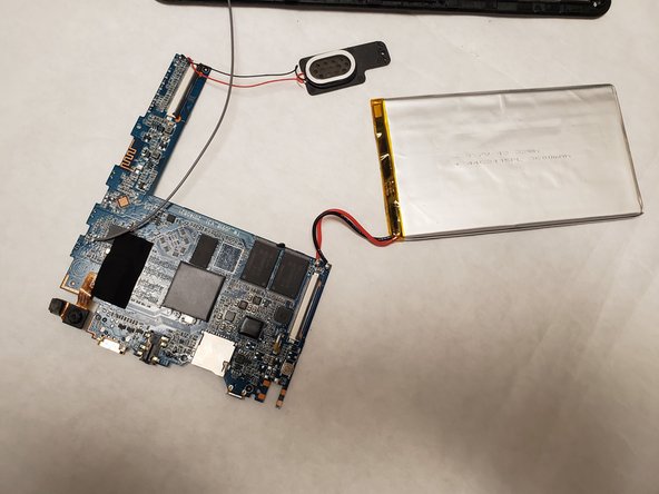

    8. Craig Electronics CMP773 Screen Replacement: 步骤 8 中的图像 1,1
      • Using needle nose pliers, remove the ground wire from the casing.
      询问修复机器人
      添加评论
    9. Craig Electronics CMP773 Screen Replacement: 步骤 9 中的图像 1,1
      • Using the plastic opening tool, remove the battery.

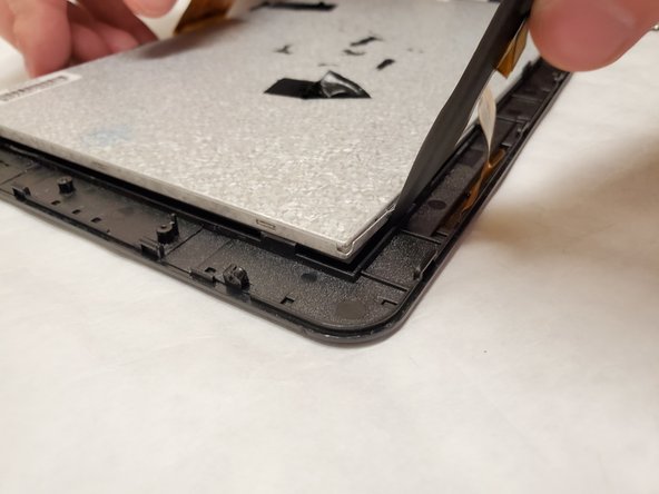

    12. Craig Electronics CMP773 Screen Replacement: 步骤 12 中的图像 1,3 Craig Electronics CMP773 Screen Replacement: 步骤 12 中的图像 2,3 Craig Electronics CMP773 Screen Replacement: 步骤 12 中的图像 3,3
      • Grasp the exposed screen corner and gently separate the screen from the housing.
