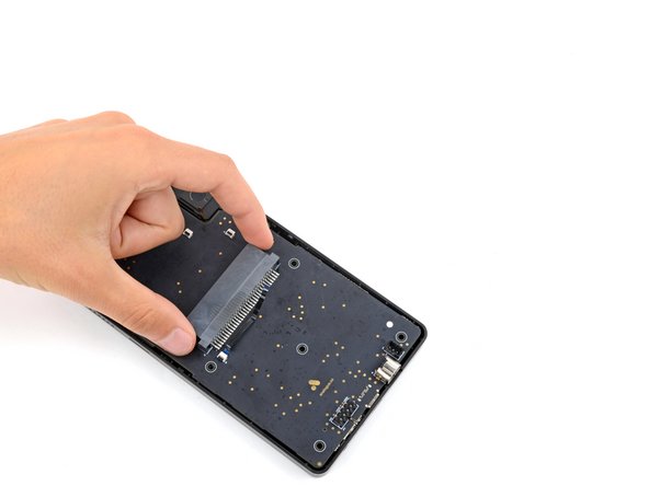

  9. Analogue Pocket Buttons Replacement, Remove the board: 步骤 9 中的图像 1,2 Analogue Pocket Buttons Replacement, Remove the board: 步骤 9 中的图像 2,2
    • Remove the board.

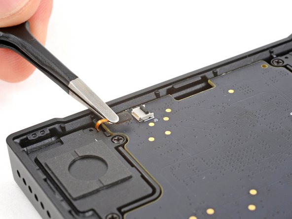

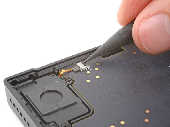

  12. Analogue Pocket Buttons Replacement, Disconnect the main board: 步骤 12 中的图像 1,3 Analogue Pocket Buttons Replacement, Disconnect the main board: 步骤 12 中的图像 2,3 Analogue Pocket Buttons Replacement, Disconnect the main board: 步骤 12 中的图像 3,3
    • Use the tip of a spudger or a clean fingernail to flip up the hinged locking flap on the right speaker cable ZIF connector.
    • Use blunt nose tweezers to pull the cable straight out of its socket.

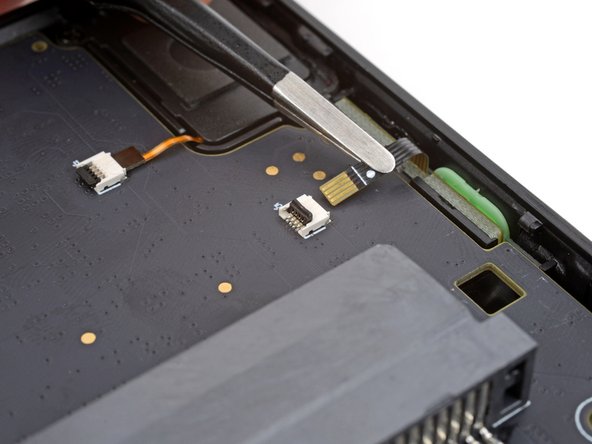

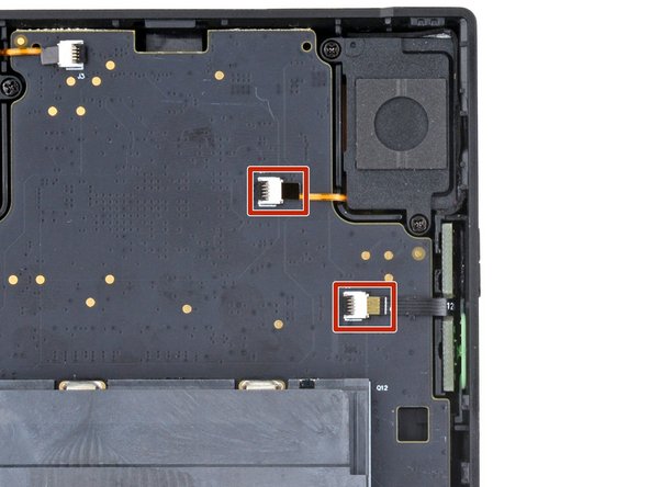

  13. Analogue Pocket Buttons Replacement: 步骤 13 中的图像 1,3 Analogue Pocket Buttons Replacement: 步骤 13 中的图像 2,3 Analogue Pocket Buttons Replacement: 步骤 13 中的图像 3,3
    • Repeat the process to disconnect the left speaker and power/volume button cables from their ZIF connectors.

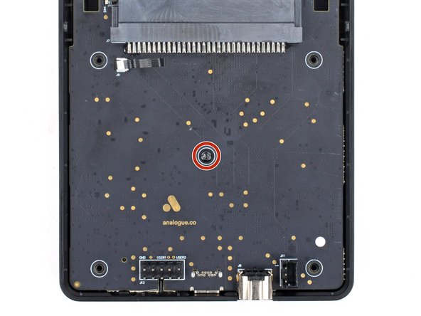

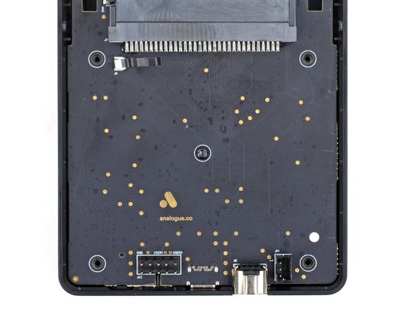

  14. Analogue Pocket Buttons Replacement, Unfasten the main board: 步骤 14 中的图像 1,2 Analogue Pocket Buttons Replacement, Unfasten the main board: 步骤 14 中的图像 2,2
    • Use a T6 Torx screwdriver to remove the 7.4 mm‑long screw securing the main board.

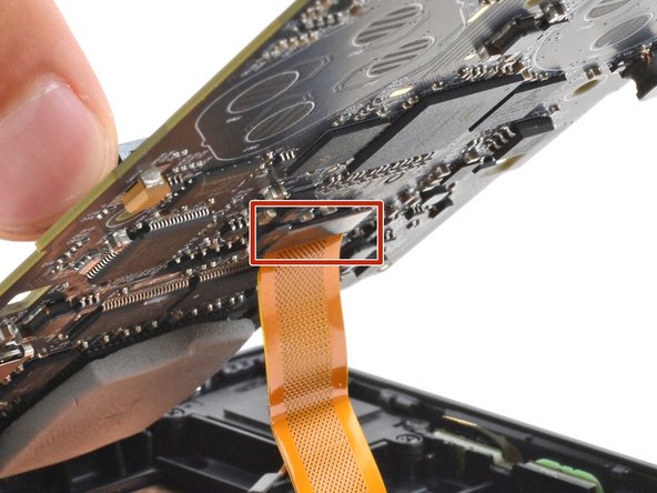

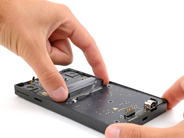

  15. Analogue Pocket Buttons Replacement, Raise the main board: 步骤 15 中的图像 1,3 Analogue Pocket Buttons Replacement, Raise the main board: 步骤 15 中的图像 2,3 Analogue Pocket Buttons Replacement, Raise the main board: 步骤 15 中的图像 3,3
    • Don't try to fully remove the board—a delicate ribbon cable connects it to the screen.
    • Before lifting the board, double-check that you removed the SD card.
    • Grip the outer edges of the cartridge reader and gently lift the bottom edge of the main board until you can access the screen cable.
    • Keep the main board raised for the next step.
    • During reassembly, make sure none of the three main board cables get stuck under the board when lowering it into place.

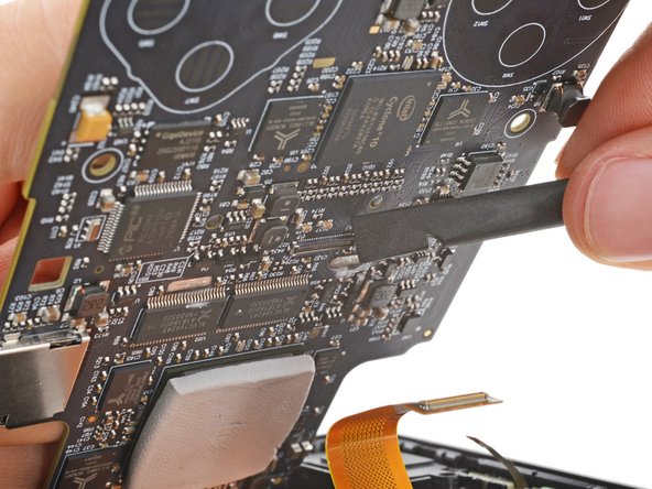

  16. Analogue Pocket Buttons Replacement, Disconnect the screen: 步骤 16 中的图像 1,2 Analogue Pocket Buttons Replacement, Disconnect the screen: 步骤 16 中的图像 2,2
    • Be very careful not to scrape off or damage any surface mounted components during this step.
    • Insert the flat end of a spudger under the top right corner of the screen cable press connector.
    • Twist the spudger to disconnect the screen cable.
    • To re-attach press connectors like this one, carefully align and press down on one side until it clicks into place, then repeat on the other side. Don't press down in the middle. If the connector is misaligned, the pins can bend and cause permanent damage.

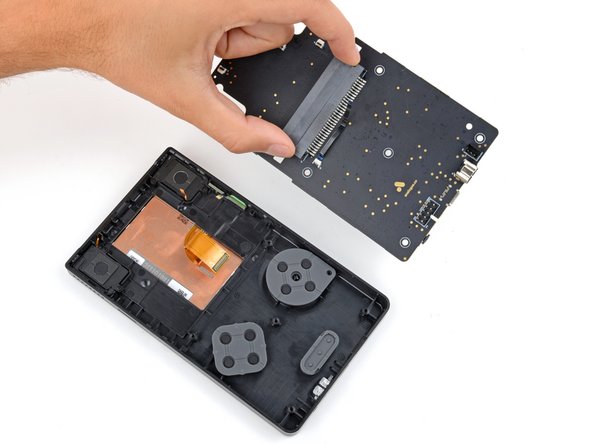

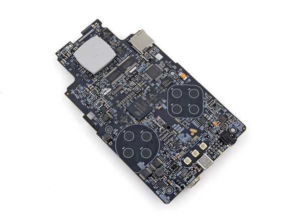

  17. Analogue Pocket Buttons Replacement, Remove the main board: 步骤 17 中的图像 1,3 Analogue Pocket Buttons Replacement, Remove the main board: 步骤 17 中的图像 2,3 Analogue Pocket Buttons Replacement, Remove the main board: 步骤 17 中的图像 3,3
    • Lift and remove the main board from the front shell.
    • To prevent damaging any surface mounted components, lay the board on your workspace cartridge reader side down.
    • If any part of the thermal pad came off the large CPU on the board's top edge, use your fingers to gently put it back in place.
