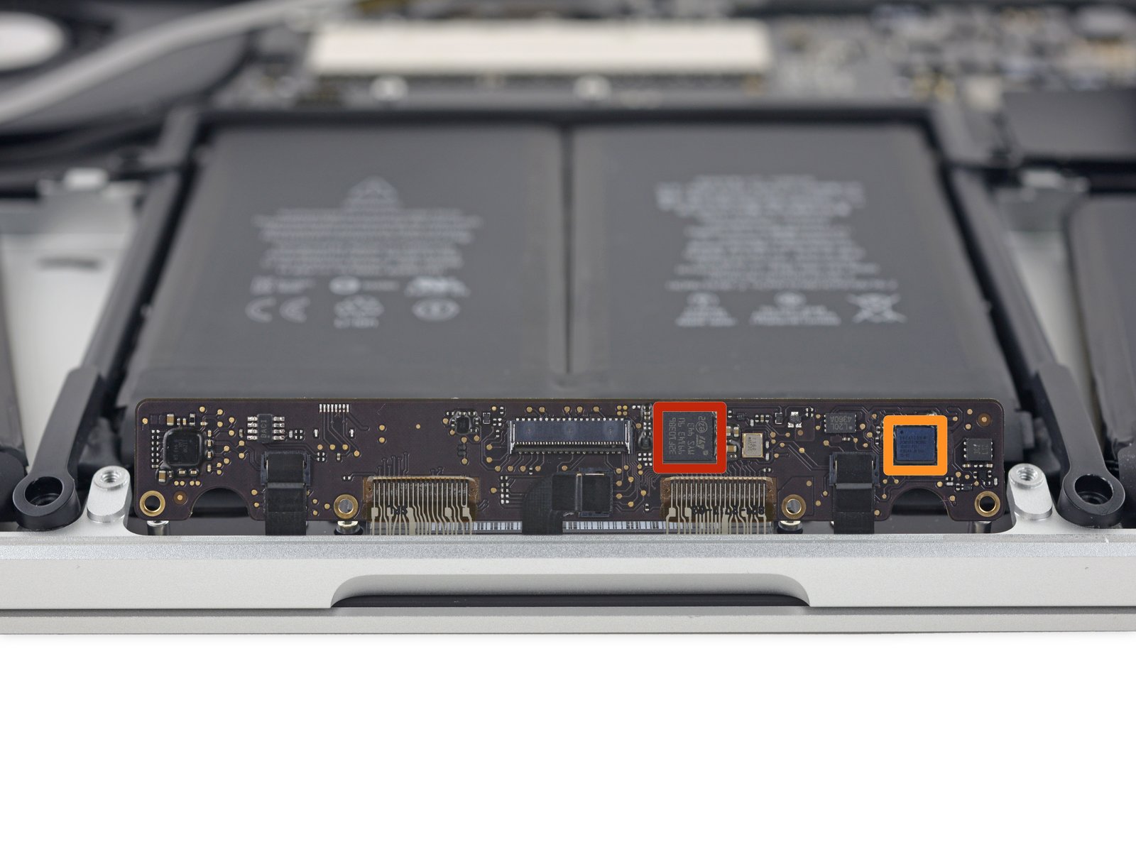

I have the common problem of a non-responding trackpad and keyboard. (USB still working) I already changed the trackpad flexcable as suggested here:
Keyboard and trackpad are unreponsive?

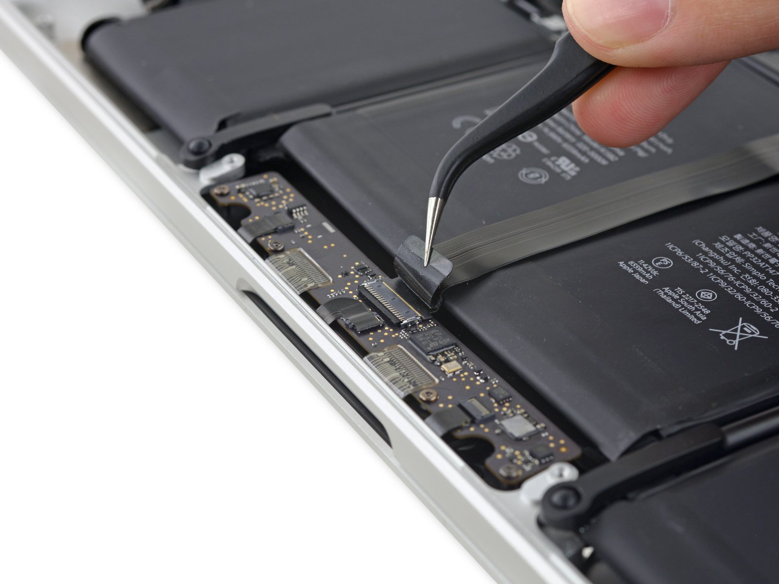

Anyway it didn’t work out. So I took a closer look at the trackpad (I got the MBP used and the previous owner changed the battery some time ago) and saw some suspicious marks on the trackpadboard:
Compared to other images it looks like something is missing:
https://d3nevzfk7ii3be.cloudfront.net/ig...
Do you think replacing the trackpad could solve the problem?
Best regards
Daniel

Yes! Thats what I would do. MacBook Pro 13" Retina 显示屏 2015早期 触摸板更换 and here’s the part MacBook Pro 13" Retina (Early 2015) Trackpad

Thank you Dan for your advice. I changed the trackpad an now it works perfectly.
