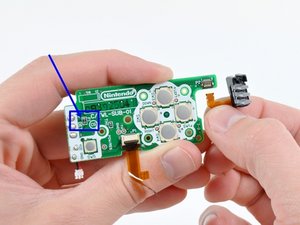

could have blown a fuse
这个答案有帮助吗?
得分 0
2条评论:
I'm using a power board that has that fuse bridged.
完成的
see any shorts in the connectors for the flex cables
otherwise if the bottom LCD isn't working the unit wont boot
