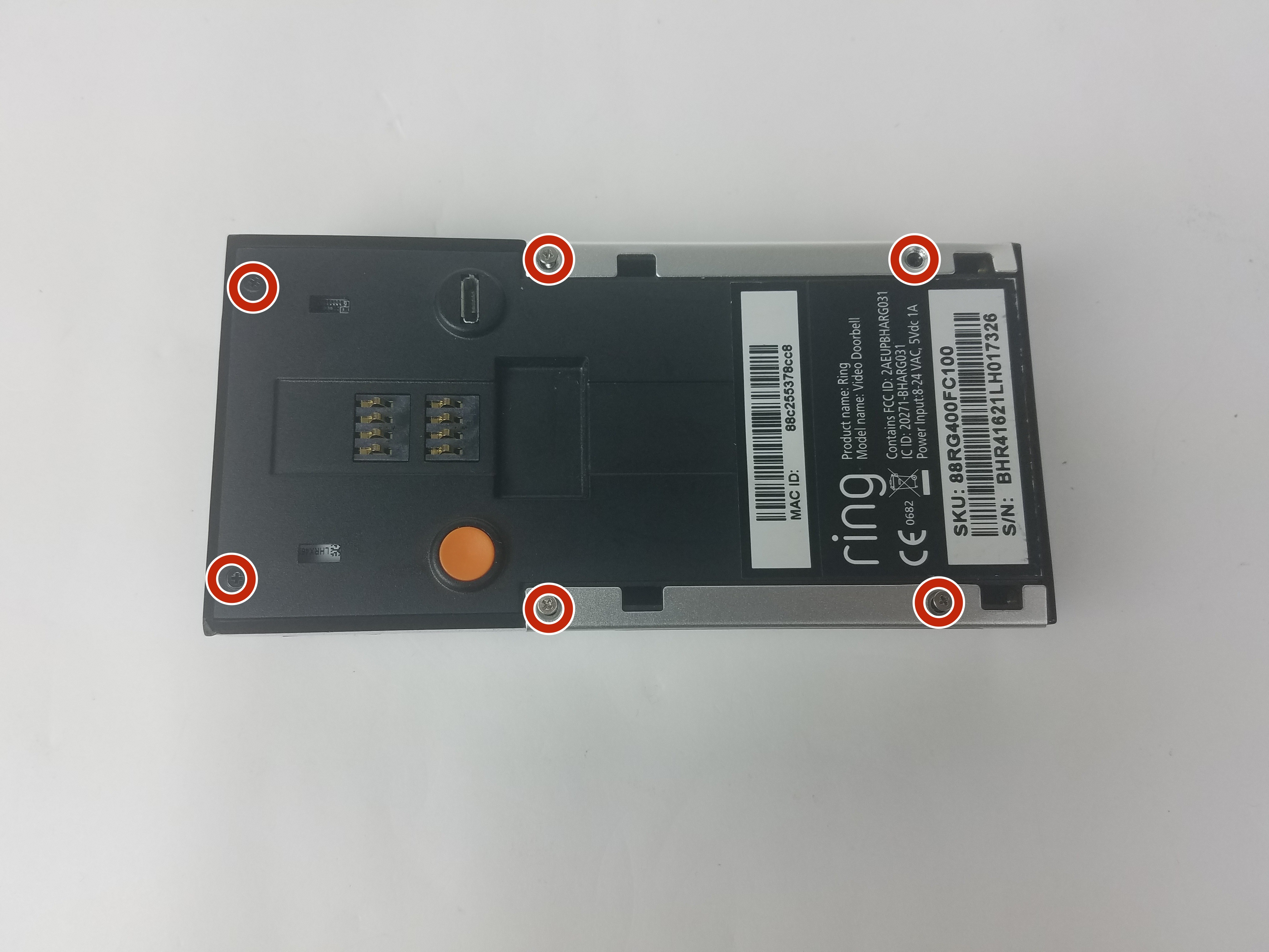

The unit was operating normally, but the supply transformer is dead, likely due to overload, and a replacement transformer sees a high current flow. At 0,5 Amps AC, only 1 Volt at the Ring terminals. How to repair the circuit board?

Post some close up pictures of the motherboard so that it can be seen if there are any obvious problems.
Here's how to do this 在已经存在的问题里加入图片
You probably don't need this but here's a link to the ifixit Ring Video Doorbell Motherboard Replacement guide which may be of some help in gaining access to the motheboard

I will disassemble the Ring in October to check what went wrong on the mother board, and either repair this AC supply or arrange a 5V DC supply through the USB charging...!
