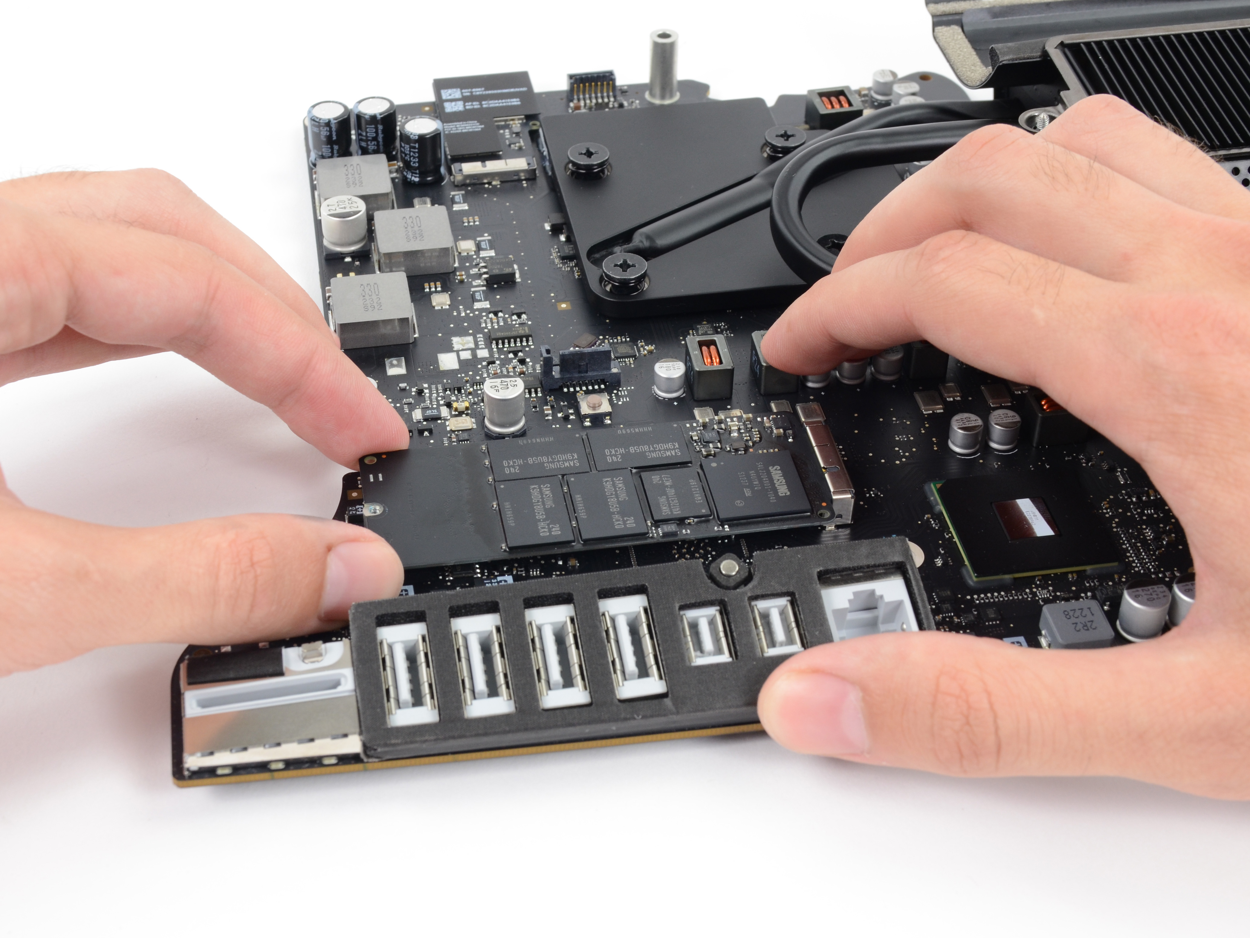

iMac 27 late 2012 the ssd was upgraded but ths system doesnt see it. And the kernel_task use 500% of CPU. I think the problem is SSD. Where I can buy an SSD for it?https://d3nevzfk7ii3be.cloudfront.net/ig...

Was this added as a primary or secondary drive? Did you install it directly or format it externally? If booting from your original drive use Disk Utilities and format the drive GUID before trying to use.
UPDATE
The 4sns/1/4000000 TH00-900 is a hard drive temperature sensor. Looks like the original hard drive has been changed without addressing the possible Apple priority firmware issue. lease tell us what the main hard drive is, make and model number and if it has an Apple logo on it. Your fan is probably running at high speed too. I'd like you to check your exact machine by entering the serial number here and let me know:
http://www.everymac.com/ultimate-mac-loo...
Next you need to get a cheap external enclosure or a universal adapter to address the SSD externally. Please tell us exactly what it is.

iMac "Core i5" 3.2 27-Inch (Late 2012), I have removed the SSD becaouse it doesn't work. The HDD I think isn't genuine because there is no Apple logo and it is 3TB WD. And also I have changed the display.
完成的
Check again for an Apple logo, it might be stock. If it does not have one you will need to get a In-line sensor from OWC: https://eshop.macsales.com/item/OWC/DIDI...
Standard Hard Drive: 1 TB (7200 RPM) Int. HD Interface: Serial ATA (6 Gb/s)
Details: This model also could be custom configured with a 3 TB hard drive for an extra US$150, a 1 TB or 3 TB "fusion drive" -- which combines a traditional hard drive with 128 GB of flash RAM -- for an extra US$250 or US$400, respectively, or a 768 GB SSD for an extra US$1300.
完成的
Hi. I have bought OWC cable as you adviced but the cpu overload doesnt disappear . Now I'm getting hard test error 4sns 1 c0000008 tl0p 124. What can I check? Any ideas?

Hi. Yes The problem is solved. It was LCD sensor. There is a little wire with sensor behind the screen I had forgot to connect it :)
