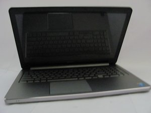

The Dell Inspiron 15-7537 is a 15.6" touchscreen laptop with an i5 core processor.
Why does the screen stay black when the computer is on?
When I turn on my Dell Inspiron 15-7537 the power light comes on, but the screen stays black.

Connect an external monitor to make sure that you are getting video out to it. If that works you are having an issue with your LCD. If it does not, you are looking at some GPU problem. Let us know what you find.

You need to connect an external monitor on your computer and then check are you still getting the same problem . if you are getting the same problem then you need to open your laptop and clean ram and processor fan.
Now install the fan and ram back in and then power on your laptop it should work fine now.

Have same issue works on external but black screen on lcd ,try diagnostic pressing power button and D show all colour clear and stay black ,replace different cable and lcd still same

I am facing the same issue, when i am connecting an external monitor not sure how to swtich the display. As i am not able to get any option on the screen.
