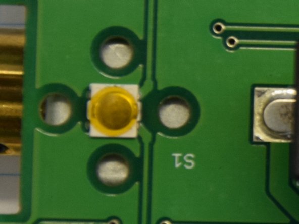

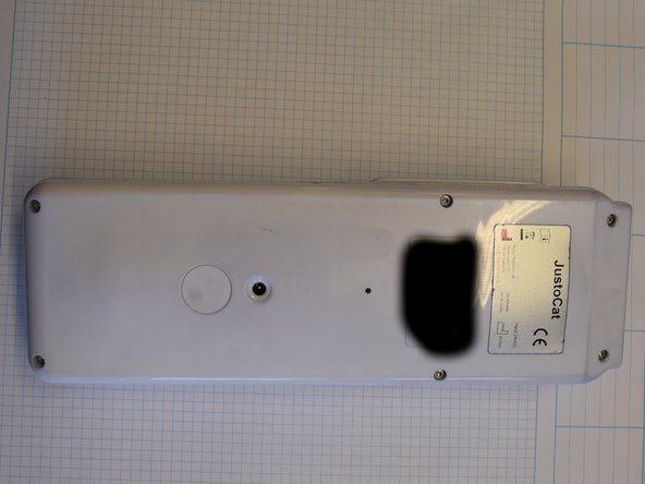

  1. Repair of a cat for therapy, Push button: 步骤 1 中的图像 1,2 Repair of a cat for therapy, Push button: 步骤 1 中的图像 2,2
    • Remove six screws with Torx T10 on the backside of the device.

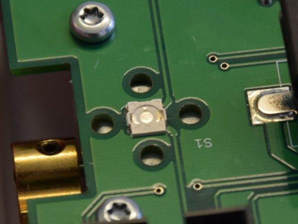

  2. Repair of a cat for therapy: 步骤 2 中的图像 1,3 Repair of a cat for therapy: 步骤 2 中的图像 2,3 Repair of a cat for therapy: 步骤 2 中的图像 3,3
    • Just for information, it is NOT necessary to remove the printed circuit board! There are three connectors: speaker, battery and sensor.

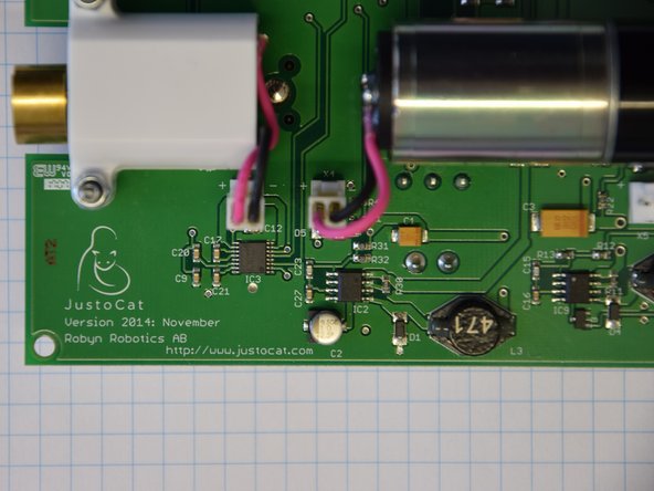

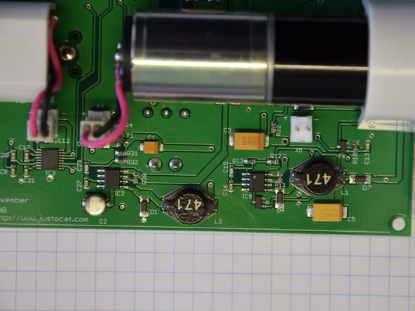

  3. Repair of a cat for therapy: 步骤 3 中的图像 1,3 Repair of a cat for therapy: 步骤 3 中的图像 2,3 Repair of a cat for therapy: 步骤 3 中的图像 3,3
    • Just for information, it is NOT necessary for the repair!
  4. Repair of a cat for therapy: 步骤 4 中的图像 1,2 Repair of a cat for therapy: 步骤 4 中的图像 2,2
    • Button: pick the membrane and the adhesive stick up, clean with glass fiber brush and some Isopropyl alcohol. Let it dry, reassemble it. Fix it with some tape of Teflon.
    • Test it, you should feel the pressure point with a click.

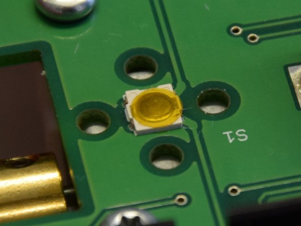

  5. Repair of a cat for therapy, Secure the membrane with adhesive tape: 步骤 5 中的图像 1,3 Repair of a cat for therapy, Secure the membrane with adhesive tape: 步骤 5 中的图像 2,3 Repair of a cat for therapy, Secure the membrane with adhesive tape: 步骤 5 中的图像 3,3
    • Example of securing with Teflon tape or similar thin adhesive tape.
    • I did not try the following: One could add a coil spring arround the white part of the push button of the case. The Spring could relieve the small button.
