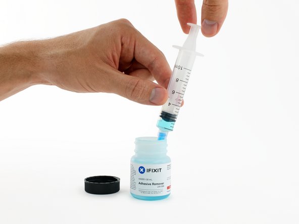

  54. MacBook Pro 15" Retina Display Mid 2015 Battery Replacement (Legacy): 步骤 54 中的图像 1,2 MacBook Pro 15" Retina Display Mid 2015 Battery Replacement (Legacy): 步骤 54 中的图像 2,2
    • Open your container of adhesive remover.
    • Fill the syringe included in your kit with a small amount (approximately 1-2 milliliters) of adhesive remover.
    • It's best to fill the syringe with no more than about 1-2 milliliters of adhesive remover at a time, so as to avoid accidentally applying too much.
    • Refill your syringe as needed throughout the rest of this procedure.

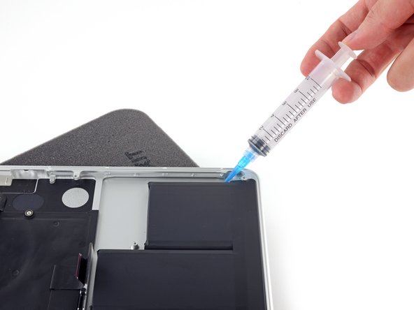

  55. MacBook Pro 15" Retina Display Mid 2015 Battery Replacement (Legacy): 步骤 55 中的图像 1,2 MacBook Pro 15" Retina Display Mid 2015 Battery Replacement (Legacy): 步骤 55 中的图像 2,2
    • Apply a small amount of adhesive remover (approximately 1 ml) evenly along the elevated edge of the outer right battery cell.
    • Wait 2-3 minutes for the liquid adhesive remover to penetrate underneath the battery cell before you proceed to the next step.

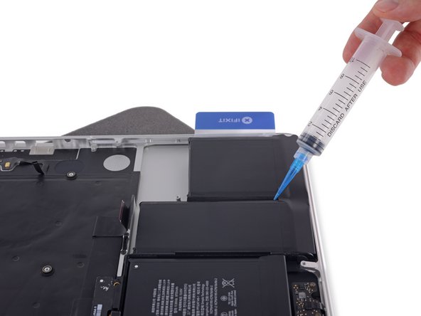

    • Apply a small amount of adhesive remover (approximately 1 ml) evenly along the elevated edge of the next battery cell.

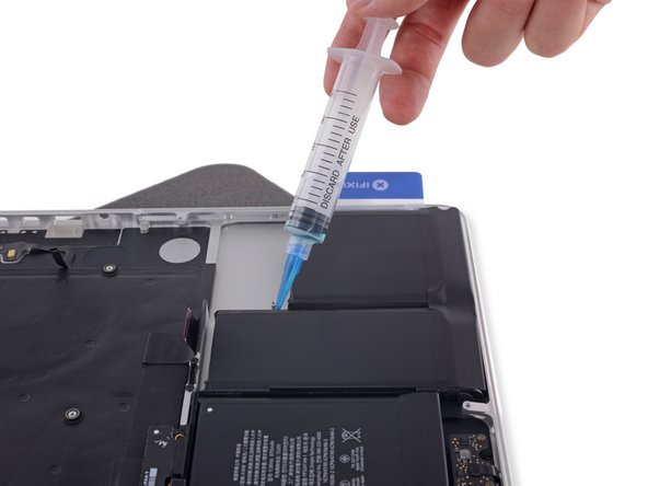

    • With the left edge of your MacBook Pro still propped up, apply a small amount (about 1 ml) of adhesive remover down the center line between the two middle battery cells.
    • Wait 2-3 minutes for the adhesive remover to penetrate before you continue.

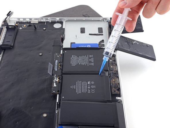

  68. MacBook Pro 15" Retina Display Mid 2015 Battery Replacement (Legacy): 步骤 68 中的图像 1,2 MacBook Pro 15" Retina Display Mid 2015 Battery Replacement (Legacy): 步骤 68 中的图像 2,2
    • Apply a small amount (about 1 ml) of adhesive remover between the two center battery cells, so that it flows underneath the remaining battery cell.
