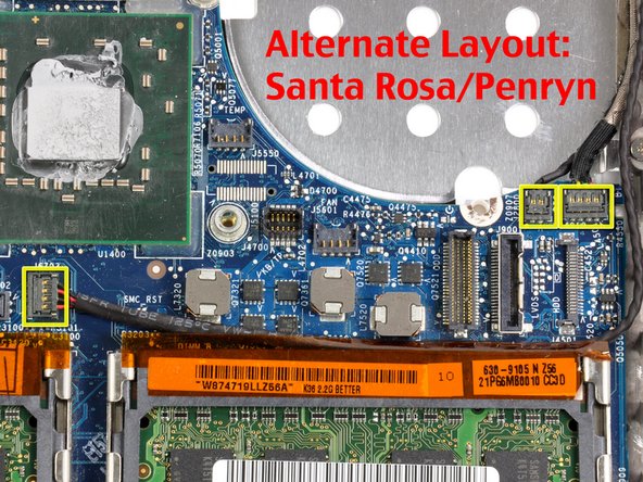

    • Disconnect the orange optical drive ribbon cable connector from the logic board by prying it straight up using either a finger or a spudger.
  16. MacBook Core 2 Duo Lower Case Replacement: 步骤 16 中的图像 1,1
    • Disconnect the newly revealed display data cable's plug from the logic board by pulling it upward using its black pull-tab.
    • If there is no pull-tab on top of the plug, it may be helpful to use a spudger to disconnect this plug.
  17. MacBook Core 2 Duo Lower Case Replacement: 步骤 17 中的图像 1,1
    • Disconnect the newly-revealed hard drive cable's plug from the logic board by pulling it upward using its black tab.
    • When reconnecting the hard drive cable's plug to the logic board, make sure the plug is routed under the cables for the right speaker and the microphone, or else the plug won't sit flush with the logic board, which will prevent the plug from fully engaging with its socket on the logic board.

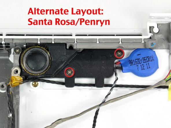

    • For Santa Rosa/Penryn and 2009 models, which don't have a c-channel:
    • Remove only the single 3 mm Phillips screw from the right speaker, and skip step 26.
  25. MacBook Core 2 Duo Lower Case Replacement: 步骤 25 中的图像 1,1

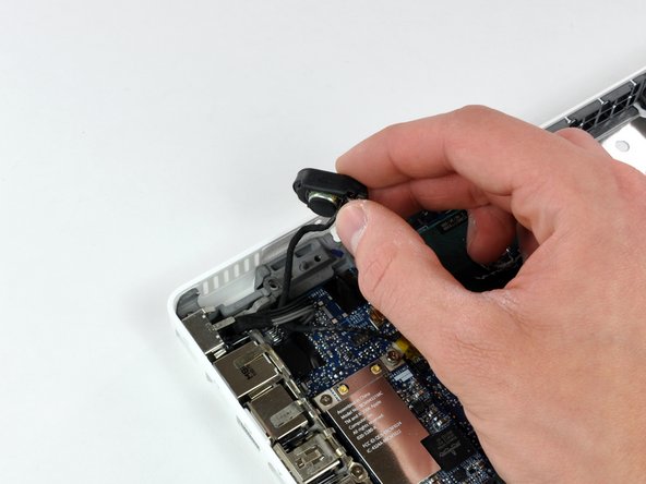

    • Lift the right speaker out of its housing and set it to the side.

  37. MacBook Core 2 Duo Lower Case Replacement: 步骤 37 中的图像 1,2 MacBook Core 2 Duo Lower Case Replacement: 步骤 37 中的图像 2,2
    • Core Duo and original Core 2 Duo models (photo 1):Disconnect the two newly-revealed temperature sensor connectors and the fan connector from the logic board. These connectors move up vertically off of the logic board, NOT pulled towards the rear of the case, and can be lifted with gentle pressure from under the cable.
    • Santa Rosa/Penryn models (photo 2): There is only one temperature sensor connector containing all four wire leads.
    • Early and Mid 2009 models don't have a separate temperature sensor attached to the heat sink, and thus no cable for it, so nothing is plugged into the temperature sensor connector.

  42. MacBook Core 2 Duo Lower Case Replacement: 步骤 42 中的图像 1,2 MacBook Core 2 Duo Lower Case Replacement: 步骤 42 中的图像 2,2
    • Use a spudger to lift the left speaker out of its housing. Grasp it with your fingers and set it aside.
    • The left speaker cable is still connected to the logic board.
    • Disconnect the MagSafe board connector plug from the logic board, by grasping its cable and pulling it to the right.

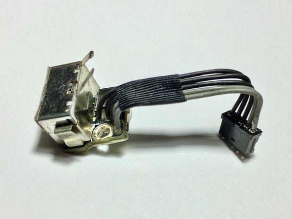

  46. MacBook Core 2 Duo Lower Case Replacement: 步骤 47 中的图像 1,2 MacBook Core 2 Duo Lower Case Replacement: 步骤 47 中的图像 2,2
    • The MagSafe board is now free of all connections and can be detached freely from the logic board.
    • Using your fingers, pull out the MagSafe board.
    • Note that the MagSafe board may have a small EMI shield that fits onto the rear of the MagSafe housing; this shield may come loose as you remove the MagSafe board, but remember to reinstall it during reassembly.

  52. MacBook Core 2 Duo Lower Case Replacement: 步骤 53 中的图像 1,2 MacBook Core 2 Duo Lower Case Replacement: 步骤 53 中的图像 2,2
    • Remove the two 3.5mm Phillips screws securing the subwoofer to the lower case.
    • On the Santa Rosa/Penryn models, the screw pattern is slightly different. See second picture.
