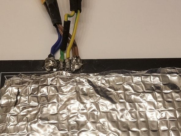

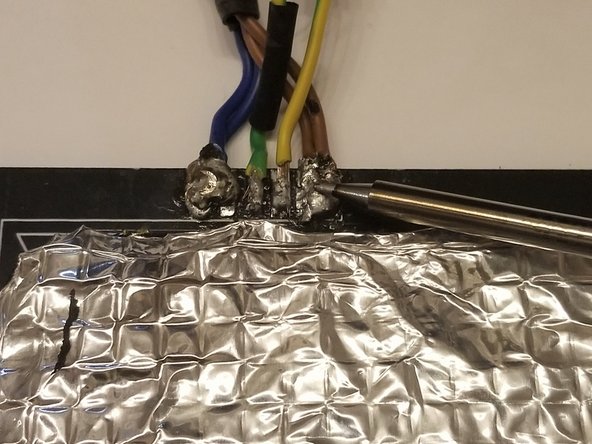

    • Desolder the damaged cable or connector.
    • For tips on soldering, check out the 如何焊接和拆焊 guide.
    • Take note of the polarity and which is for power and the thermistor. You may wish to take a picture for future reference. Red is for '+', Black is for '-'.
    • Do not use force to remove the cable or connector; doing this may rip the pads out.
    • Work in a well ventilated area when soldering; a fume extractor is recommended.

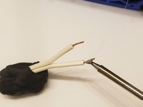

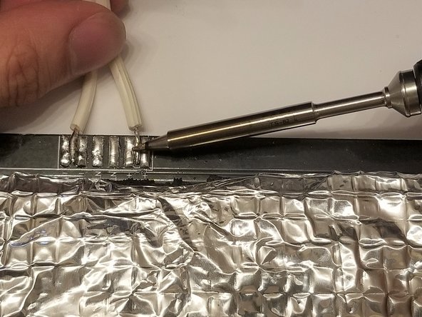

    • Strip 1/4" from both ends of the wire and tin.
    • Check out the following guide for help with stripping wires: 剥线.
    • Solder the wire onto the heated bed.
    • It is safe to bridge the connection if both pads are of the same polarity.
    • If your bed has a built-in LED, polarity will matter, otherwise it does not matter. Polarity does not matter on thermistor.
