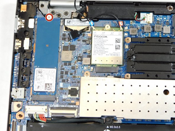

    • Use the Phillips #0 screwdriver to remove the 3 mm screw holding the SSD in place.

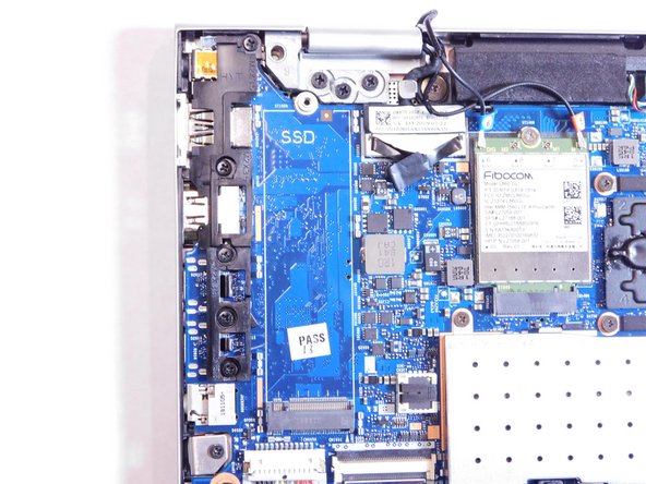

    • When the 3 mm screw is removed, the SSD will pop up from the motherboard.
    • Gently grasp the SSD, and pull the SSD out while avoiding the other components.

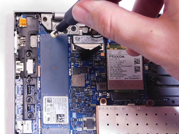

    • The SSD is now safely removed from the laptop and can now be replaced or upgraded.
