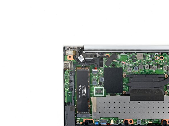

  8. HP EliteBook 835 G7 SSD Replacement, Remove SSD cover: 步骤 8 中的图像 1,2 HP EliteBook 835 G7 SSD Replacement, Remove SSD cover: 步骤 8 中的图像 2,2
    • Use the pull tab to lift and remove the SSD cover from the motherboard.
    • During reassembly, there are clips that fasten the SSD cover to the motherboard. Line up the edges of the SSD cover with the clips and push down on the cover to secure it.
  9. HP EliteBook 835 G7 SSD Replacement, Remove the SSD screw: 步骤 9 中的图像 1,2 HP EliteBook 835 G7 SSD Replacement, Remove the SSD screw: 步骤 9 中的图像 2,2
    • Use a Phillips screwdriver to remove the 2.5 mm screw securing the SSD.
  10. HP EliteBook 835 G7 SSD Replacement, Remove the SSD: 步骤 10 中的图像 1,3 HP EliteBook 835 G7 SSD Replacement, Remove the SSD: 步骤 10 中的图像 2,3 HP EliteBook 835 G7 SSD Replacement, Remove the SSD: 步骤 10 中的图像 3,3
    • Pull the SSD out of its socket and remove it. Keep the SSD as parallel to the motherboard as possible when pulling on it.
    • Do not pull up at a sharp angle as this could damage the SSD and the socket.
