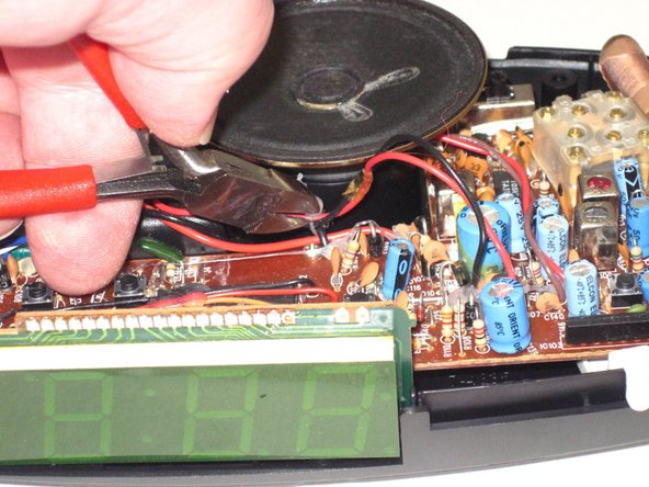

  6. GE 7-4836B Alarm Clock AM-FM Radio AM-FM Switch Replacement, Battery Wires Wire Tie: 步骤 6 中的图像 1,2 GE 7-4836B Alarm Clock AM-FM Radio AM-FM Switch Replacement, Battery Wires Wire Tie: 步骤 6 中的图像 2,2
    • Using the wire cutters, carefully cut the plastic wire tie.

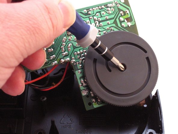

  9. GE 7-4836B Alarm Clock AM-FM Radio AM-FM Switch Replacement, AM-FM Switch Dial Screw: 步骤 9 中的图像 1,2 GE 7-4836B Alarm Clock AM-FM Radio AM-FM Switch Replacement, AM-FM Switch Dial Screw: 步骤 9 中的图像 2,2
    • Raise the PCB to expose the AM-FM switch dial screw.
    • Using a Phillip's #01 Screwdriver, unscrew the one 3mm screw from the middle of the AM-FM switch dial.

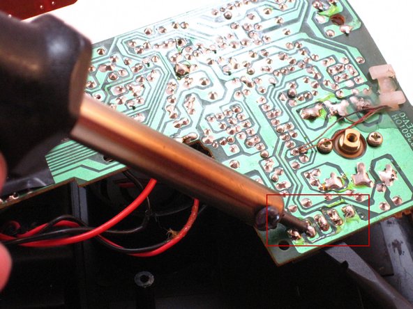

  10. GE 7-4836B Alarm Clock AM-FM Radio AM-FM Switch Replacement, AM-FM Pins: 步骤 10 中的图像 1,3 GE 7-4836B Alarm Clock AM-FM Radio AM-FM Switch Replacement, AM-FM Pins: 步骤 10 中的图像 2,3 GE 7-4836B Alarm Clock AM-FM Radio AM-FM Switch Replacement, AM-FM Pins: 步骤 10 中的图像 3,3
    • Locate the AM-FM pins on the PCB.
    • Carefully apply the hot soldering iron to the solder on top of the AM-FM pins.
    • Gently and firmly push on the pins with the Spudger to remove the switch from the underside of the PCB.
