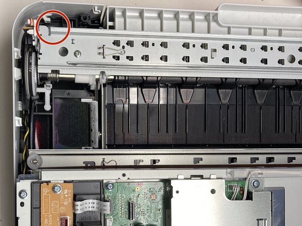

  1. Brother MFC-J4420DW Power supply replacement, Removing hood holder: 步骤 1 中的图像 1,3 Brother MFC-J4420DW Power supply replacement, Removing hood holder: 步骤 1 中的图像 2,3 Brother MFC-J4420DW Power supply replacement, Removing hood holder: 步骤 1 中的图像 3,3
    • Disconnect the power cord of the printer
    • Open the printer as you would to access the USB port.
    • Pull out the rear end of the hood holder (see picture two). After that you can remove the top part of the hood holder.
    • Now remove the hood holder completely.
    • It is quite useful to put the printer near something so that you can lean the top against something, for example a wall.
