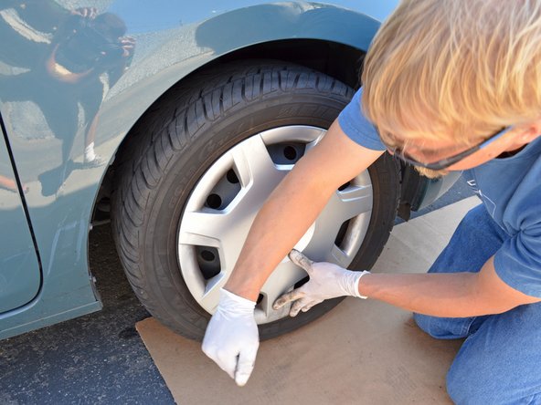

    • Loosen the lug nuts on the passenger side front wheel a half turn with a 22 mm wrench or tire iron.
    • If you have steel wheels with wheel covers, use a large flat head screwdriver or the tip of the emergency tire iron to pry off the wheel cover to access the lug nuts.

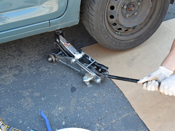

    • Jack up the front right corner of the car by placing a jack under the long vertical portion of the frame directly behind the wheel well.
    • Raise the car until the wheel is a couple inches off the ground
    • Place a jack stand between the two notches in the frame a few inches back from the jack.
    • Slowly lower the car onto the jack stand.
    • Many hydraulic jacks are lowered by placing the open end of the handle over a knob and turning it counterclockwise. Consult the owner's manual for your jack if you don't know how to lower it.
    • Never work underneath a car that is only supported by a jack. The jack may slip or fail, resulting in serious injury or death.

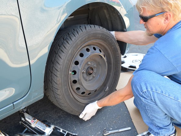

    • Unscrew and remove the five lug nuts from the wheel.
    • Pull the wheel off the hub and set it aside.

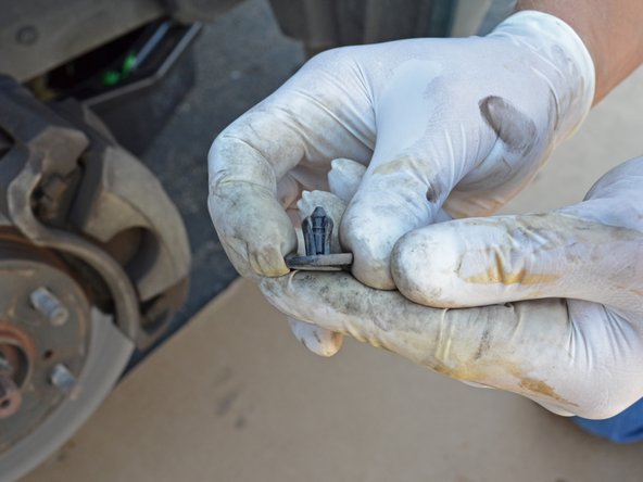

  4. 2008-Present Scion xB Oil Change: 步骤 4 中的图像 1,3 2008-Present Scion xB Oil Change: 步骤 4 中的图像 2,3 2008-Present Scion xB Oil Change: 步骤 4 中的图像 3,3

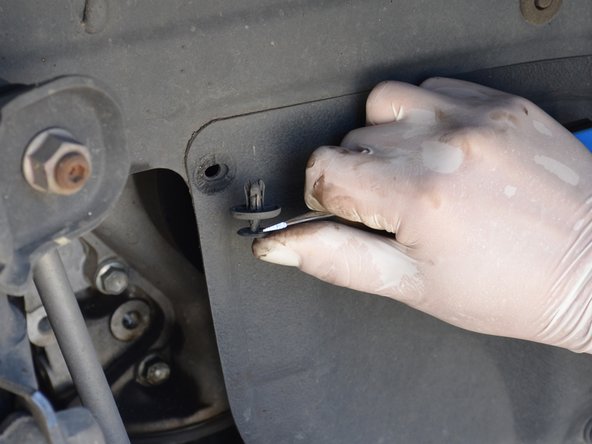

    • Remove the three visible push retainers from the flap located towards the front of the wheel well.
    • There are two more retainers that can not be seen, but they do not need to be removed.
    • Remove the retainers by first prying the inner push pin with a flat head screw driver and then pulling out the inner and outer pieces together.

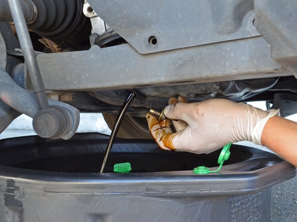

    • Locate the oil drain plug at the back passenger side corner of the oil pan and place an oil drain pan underneath it.
    • Use a 14 mm socket or box end wrench to loosen the drain plug a couple turns.
  6. 2008-Present Scion xB Oil Change: 步骤 6 中的图像 1,2 2008-Present Scion xB Oil Change: 步骤 6 中的图像 2,2
    • Loosen the drain plug by hand until it comes off completely and oil begins to drain out of the oil pan.
    • Watch the draining oil for shiny specks. Metal flakes in the oil could mean that there is a serious problem with the internals of your engine.

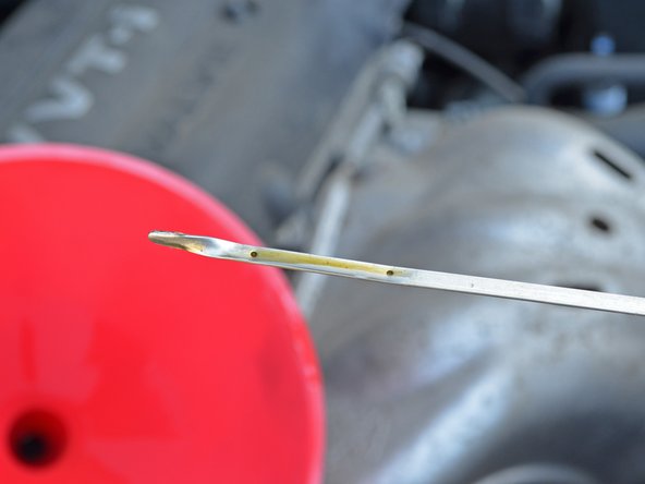

    • Grab the yellow handle of the engine oil dipstick at the front of the engine and pull the dipstick out.
    • Wipe down the dipstick with a rag or towel, reinsert it, then pull it out again to get a an oil level reading.
    • The oil level should be somewhere between the two holes, which denote the minimum and maximum levels. Add or drain oil as necessary until you have an appropriate level.
    • It takes one quart of oil to change the level from minimum to maximum.
    • Reinstall the dipstick and oil filler cap. Twist the cap clockwise until it is snug.

    • Replace the three push retainers by first inserting them into their respective holes with the inner pin pried up. Push the pin into place to secure each retainer.
