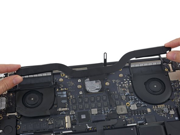

  9. 替换MacBook Pro 15" Retina 显示器2015年中期版本散热铁: 步骤 9 中的图像 1,1
    • 拆掉以下这些把散热铁固定到主板上的螺丝。
    • 一颗3.8mm T5 内梅花头螺丝
    • 两颗3.4mm T5 内梅花头螺丝
    • 当你拆除这些螺丝的时候,固定散热铁的弹性金属压条会松动。这些压条弹起来的时候小心别把螺丝弹丢了。
    • 一颗5.6mm T5 内梅花头螺丝
  10. 替换MacBook Pro 15" Retina 显示器2015年中期版本散热铁: 步骤 10 中的图像 1,2 替换MacBook Pro 15" Retina 显示器2015年中期版本散热铁: 步骤 10 中的图像 2,2
    • 把这俩弹性压条扒拉到一边别挡着散热铁。
    • 把散热铁从MacBook Pro上拿下来。
    • 若要重新组装,确保清理CPU和散热铁,并且重新涂抹散热膏。跟着这条指南来学习怎么弄。

On my macbook Pro 2015 it has an extra Square on the heatsink to cover the graphics card. So the Pictures does not look right on this guide. I would share my pictures but it’s not possible in the comments.
Mark Barner - 回复
I don’t have much to add other than that these squares on the GPU and CPU were hindering my ability to completely clean off the previous thermal paste. I actually would like to remove the squares, but would like to hear from folks who might have a sense of how essential it is for thermal transfer (or any other purpose it serves).
Rahul S -
Hey guys when I refreshed the thermal paste on my 2015 15” (top spec) mbp, I noticed four little metallic sponges in that area, one of those came off… I still have it, how critical is it? Should I replace it? If so are there any guides?
Many thanks
AlexMorse - 回复
I have the same issue as well— 2 of mine came off, and I just stuck them back where they were before and let the pressure of the heat sink hold it in place for now. But any expertise on this issue is appreciated!
Rahul S -
I too am missing some of those "little metallic sponges". Has anyone found a good replacement for them. I cannot find them online. I'm sure it's because I don't know their "official" name. Maybe I can make my own from thermal pads?
rfmorrow -
